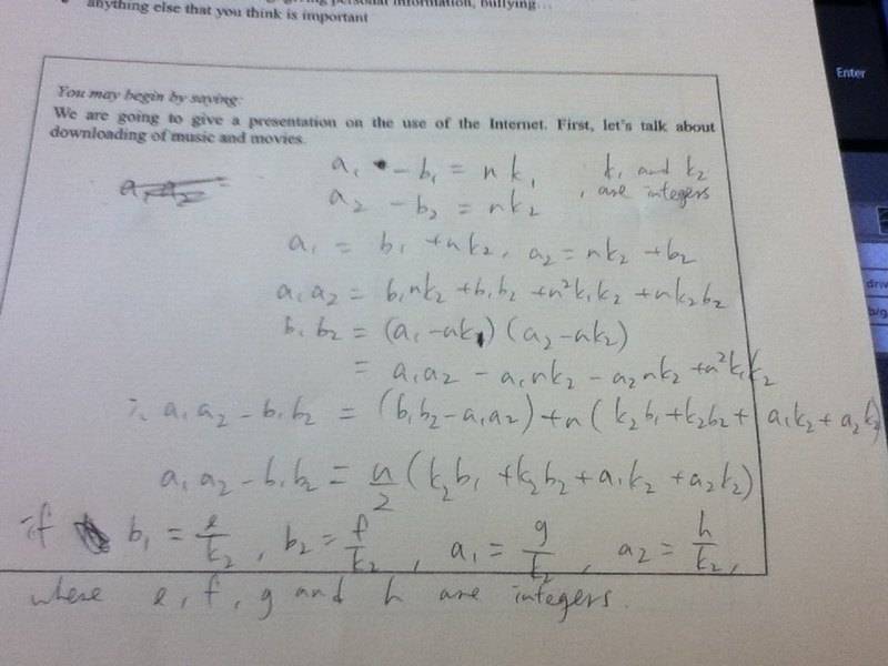

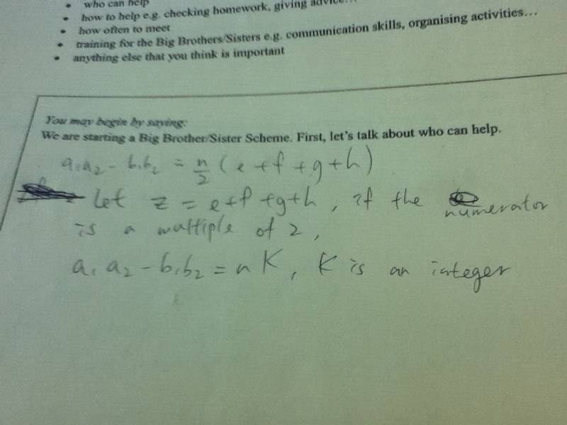

Sorry,please see the attached,I came up with a contradiction while proving the above.If my proof is correct,then the multiplicative property can be applied to rational numbers,so there must be something wrong but I couldn't find it.Thx very much

The final expression for a1a2-b1b2 should have k1 inside as well and not only k2. Anyway it seems for specific a's and b's that satisfy some extra equations, the multiplicative property could hold for those specific rationals , but you want to hold for every rational in order to be usefull.
thx for your help
