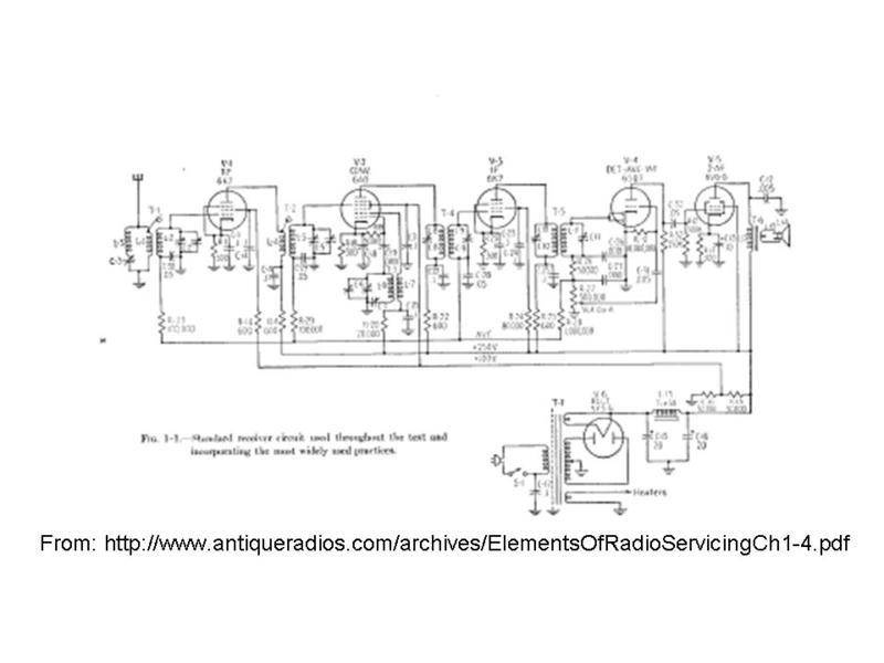

https://www.physicsforums.com/attachments/21327The RF and LO (local oscillator) tuned circuits (in attached circuit) are parallel resonances, as well as the 455 kHz bandbass amplifier. See
http://www.crystalradio.net/tubeplans/xximages/4plustube/fourtubesuperbroadcasttuner_1.jpg
The 455 kHz bandpass filter amplifier has to be high enough bandwidth to give good am fidelity, but also narrow enough to reject neighboring frequency stations (or RF signals separated by 910 kHz). I don't recall ever seeing any ceramic filters in any am vacuum tube radios, but I did repair one that had tuned ferrite inductors rather than variable capacitors for the RF and LO circuits.
[Added] Here is an AM radio ckt (in thumbnail) I like better.
Bob S

http://www.antiqueradios.com/archives/ElementsOfRadioServicingCh1-4.pdf
