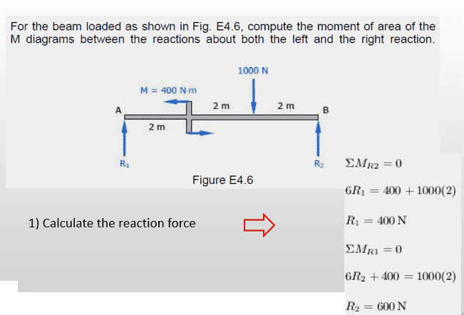

The discussion centers on the representation of a 400Nm moment in moment diagrams, specifically questioning why it is depicted as a straight line from the moment point rather than extending along the entire length of the beam. The consensus is that the moment acts locally, affecting only the region from point A to 2 meters away from A, rather than uniformly across the beam. This localized effect is crucial for maintaining equilibrium, as moments must be balanced at the supports or ends of the beam.
