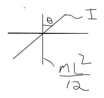

What is the Moment of inertia of rod about an axis inclined?
It is given as ## \frac{ML^2sin^2θ}{12} ## but how?
I know MOI for axis passing through center along y-axis as
## \frac{ML^2}{12} ##
Shouldn't it be ## \frac{ML^2}{12} = Icosθ ##
by taking components?
Hello Raghav,
What is the axis of rotation in your picture :smile: ?
BvU said:
Hello Raghav,
Sorry for the diagram,
The horizontal one is the rod.
The axis of rotation is the one which I have denoted by I.
The customary choice for ##\theta## is the angle between rod and axis of rotation. Perpendicular ##\Rightarrow I = {ML^2/12}## and ##\theta = 0 \ \ \Rightarrow \ \ I = 0\ \ ##.

Yeah, the angle should be between rod and axis of rotation.
Because if we know the formula ML2sin2θ/12 . Then when θ= 90° the MOI is ML2/12.
Now in the first place how to derive that formula ## I = ML^2sin^2θ/12 ## ?
I know derivation of axis passing through center and perpendicular to rod.
The derivation goes like this.
Let ## dm = \frac{Mdx}{L} ##
$$ I = \int_{\frac{-L}{2}}^{\frac{L}{2}} x^2dm $$
Therefore on simplifying and integrating we get I = ML2/12
But how to go when inclined at angle θ?

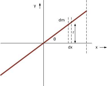

Judging from your post 6th diagram cosθ = dm/dx
But I know it is wrong dimensionally.
I am not getting the approach for dm in terms of θ.
Can you tell finally?
Okay, got it myself. Your diagram was confusing me of taking the triangle forming 90°
By now I have enough faith in you that I start to think it must be me who is so completely unclear.
How can you possibly say this ? Anyone can see that the piece called dm is longer than the piece called dx ! So, if anything at all, then ##dx = dm \cos\theta## and not vice versa !
Of course the dimension is wrong, but that you fix by changing it to mass: multiply by ##\rho## where ##\rho## has the dimension of mass/length. In short, ##\rho## is M/L and then ##\displaystyle dm = \rho \; dl = {M\over L} dl = {M\over L} {dx\over \cos\theta}##.
And if ##l## runs from 0 to L/2 in the integration, then ##x## runs from 0 to ... ?

sinθ = r/x
Shame on you ! You had the correct " ##r = x \tan\theta## " in post #7 !

Okay x should run from 0 to Lcosθ.
So $$ I = \int_0^{Lcosθ} \frac{x^2tan^2θMdx}{Lcosθ} $$ -----1)
And I have checked$$ M = \int_0^{Lcosθ} \frac{Mdx}{Lcosθ} $$
Integrating ---1) I am getting,
## I = \frac{ML^2sin^2θ}{3} ##
But I am supposed to get 12 in denominator.
No. From -Lcosθ/2 to Lcosθ/2 .

I expected you had already understood that for both integrals you have$$
\int_{-{L\cos\theta\over 2}}^{L\cos\theta\over 2} = 2 \int_0^{L\cos\theta\over 2}
The integral bounds $$ M = \int_0^{Lcosθ} \frac{Mdx}{Lcosθ} $$work without problem for ##M##, but not for ##I##. For ##M## it's as if the rod is shifted lengthwise over half its length. For ##I## you would also have to change the expression for r.
How was I suppose to know the factor of 1/4 if in the first place I don't know the formula
Which formula did you not know ?
$$M = \int dm \\ I = \int r^2 dm $$or yet another one ?
A factor of 4 is something like ##2^2##, or in this case ##2 / 2^3##. and then you go hunting for the factors 2.
