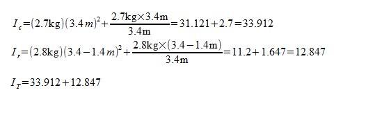

3i honestly have no idea where to go with this. i do have an attempt so please don't laugh. I took the (L) for the moment for the rod = 3.4 m and divided it into 2 parts. R sub 1 and R sub 2. With R sub 2 on half of R sub 1. The equation i got using the R sub 1 i have the moment for the disc: I = mdiscr12 + Icm and for the R sub 2 i have the moment for the rod: Ir= mrrrod2 + Icm from here i don't know what to do with them or if I am even correct in my assumptions
my thoughts is to solve those individual moments and add them together for the total moment at the pivot point
and i mispoke on the length of r sub 2 it should be the 3.4 m minus the radius of the disc?

The 1/3 comes from using the PAT. If you use the 1/12 eq, It will give you the moment of inertia of the rod about its CM. I made an error here; the r in the equation should be the total length of the rod. Next, you need to find the moment of inertia about the pivot point by adding mr2, where r is the distance of the rod's CM from the pivot point and m is the mass of the rod. Using the 1/3 equation should get you the same answer as this process, without the extra step of using the PAT. (It has already been done in the 1/3 eq for you.)
Then repeat the same process (with the appropriate equations) for the disc, and sum the results,

This is the moment of inertia of the disc about its center of mass. You need to use the parallel axis theorem to find the moment of inertia of the disc about the pivot point (+ 2.7kg(3.4m)2).
Once the moments of inertia are about the same axis, you can sum them.

Idisc= (1/2)(2.7kg)((1.4)^2) + (2.7kg)((3.4)^2)
Idisc=33.858
Itotal= Irod + Idisc
Itotal=18.8813 + 33.858
Itotal= 52.739
this 52.739 is incorrect

I get 44.65 kg∙m2:
[tex]
\begin{align*}
I_{rod} &= \frac{1}{3}ML^2 \\
&= \frac{1}{3}(2.8\,\mathrm{kg})(3.4\,\mathrm{m})^2\\
I_{rod} &\approx 10.789\,\mathrm{kg \cdot m^2}\\
I_{disk} &= \frac{1}{2}MR^2 + ML^2 \\
&= \frac{1}{2}(2.7\,\mathrm{kg})(1.4\,\mathrm{m})^2 + (2.7\,\mathrm{kg})(3.4\,\mathrm{m})^2 \\
I_{disk} &= 33.858\,\mathrm{kg \cdot m^2}\\
I_{tot} &= I_{rod} + I_{disk} \\
I_{tot} &= 44.647\,\mathrm{kg \cdot m^2}\\
\end{align*}
[/tex]
that was correct i see what my problem was it was on the Irod...I had the 1/3ml^2 + MR^2 i should have left that MR^2 off...
thanks a bunch
