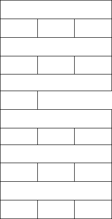

How would you determine the torque on a jenga tower if it was 12 layers how and layer 7 had 2 of its 3 blocks missing, (middle and side blocks).
Would you use that layer as the reference for the Moment formula? How would you know wether it would topple over?

Had to look up what this is about. apparently it's about this stacking game
and your problem description leads me to imagine a side view like this
am I correct so far ?##\ ##

Hi BvU, absolutely correct so far, many thanks.

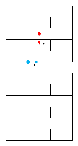

So the question is: Calculate the Net Torque on the 8th - 12th layers, and will the top part of the tower fall over?
If it does fall over, find the maximum distance that the final 7th layer block can be from the centre of the tower so that it won't fall over.
Good. So we have
(all I did was remove the two blocks from their 'default position'.)
The center of mass from the upper five layers is at the red dot. Weight of the upper section of five layers is ##F = 15\, mg## when ##m## is the mass of one block.
If we take the top right of the last block in layer 7 as origin (the blue dot), we see that there is a torque ##\tau = \vec r \times \vec F## pointing into the paper (screen...). Acting on the top section of five layers, which will topple to the right (cheating with glue is of course severely prohibited :smile: ).
You can see how far the last block in layer 7 has to be moved to the right to reduce the torque to zero.

Note that those two questions aren’t exactly the same. @maserati1969, are you sure you have stated it correctly? @BvU's phrasing seems more likely.

Great, that makes perfect sense. Thanks BvU
Yes, I see, they are more or less the same question. Thanks for the note though.
