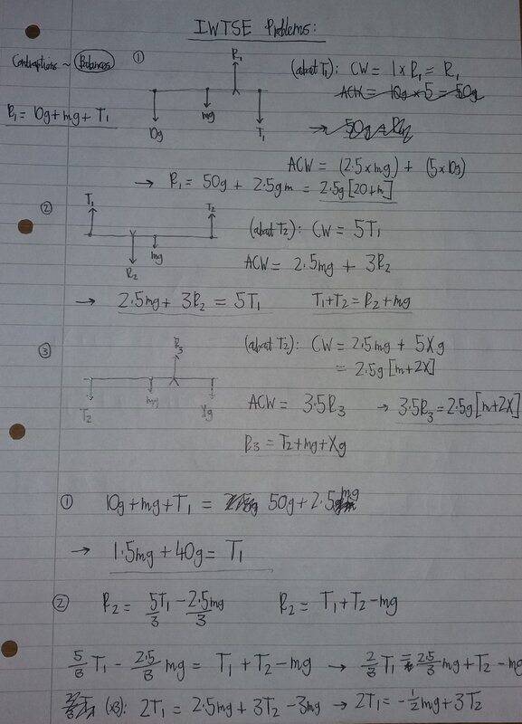

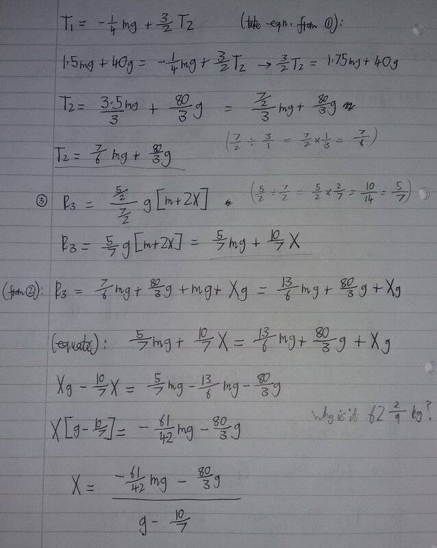

I think I have done this in an inefficient way. I assumed from the question that the three balances were of equal mass, though I'm not sure if I should have ignored their mass entirely. The correct answer is X = (62 + [2/9]) kg. Please help.
Among the three balances, first think of the left one. How much weight is there at 1m arm for 10kg weight at 4m arm ? Then think of the right one how much weight is there at 3.5m arm for X kg weight at 3.5m arm ? With these two results think of the center balance.
Yes, you should take the beams as zero mass, otherwise you do not have enough information.
At the end you have an expression X(g-10/7). Because you have not included units throughout, I am not sure what this means, but it is dimensionally inconsistent. g is an acceleration; the 10/7 may or may not be dimensionless, but it is certainly not an acceleration.
Having arrived at clear proof of an algebraic error, I would apply 'binary chop': check an equation somewhere in the middle for dimensional consistency; if that is wrong, check one quarter of the way through, else check at the three quarters mark; etc.
For this specific problem, I would not bother with calculating the reaction forces at the three fulcrums.
Using mechanical advantage should be sufficient, if allowed.

Thank you for your advice. I redid the question, assuming the beams have zero mass, and I got the right answer.
