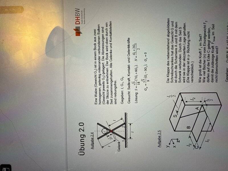

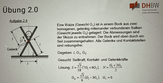

TL;DR Summary: I have this Question, and I have no idea, how am I supposed to set the Forces to create a balance since they are not perpendicular to the moving arm.
I have this question I have spend a lot of time on. It basically shows two sticks which are connected in the middle to create a Hourglass shape and on the top side there is a ball which has the mass of 1G (it is known just not a number)
Each of the sticks has their own mass which is G2. Right at the top there is a rope that holds two ends of the stick together so it won’t collapse. All the measurements that was given is on the attachment file.
What I need to figure out is how much Force the rope has. Even though one can see the answers right below it doesn’t make it understandable. Thank you everyone for helping <3
Fixing your diagram:

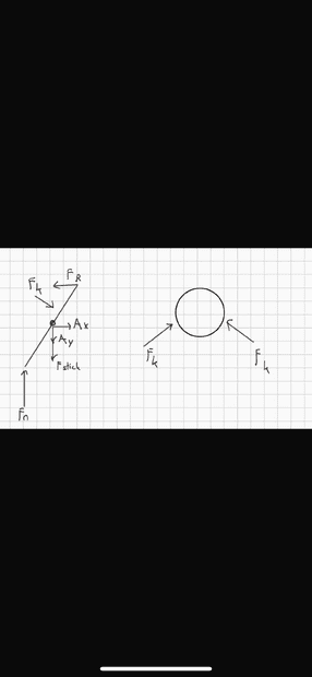

I have drawn it but cant get any further
Use the FBD of the ball to determine ##F_k##.
Use the symmetry to determine ##A_y##.

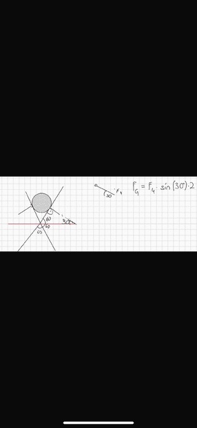

So the force Fk is Fg1 which is to see G
G1/sin(30)*2=Fk

@kozmosnak, if you take moments (torques) about the centre (where the sticks cross) you don't need ##A_x## or ##A_y##.
Yes but the problem I’m facing is that the forces are not perpendicular to the moving arm. They have angles that’s why I am confused. For example the rope force is horizontal but the axis is there with a 60 degree angle how can I add them up
Yes but the problem I’m facing is that the forces are not perpendicular to the moving arm. They have angles that’s why I am confused. For example the rope force is horizontal but the axis is there with a 60 degree angle how can I add them hp
Look at the diagram carefully:
If you are unfamiliar with this try watching the video:
G1/sin(30)*2=Fk
Yes.
See if https://www.physicsforums.com/insights/frequently-made-errors-mechanics-moments/ helps.
