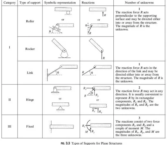

anuttarasammyak said:
Yes, my black point means hard fixed for an example by welding. I am not familiar with torque-free hinges. By replacing welding with these hinges can we change forces and torques in the static configuration?
Torque-free hinges are freely articulated or pinned connections between two members of any structure or armature, or between one member and a solid basement, like the ground, or a wall, or a concrete slab.
Those are unable to resist a circular movement with an opposite moment or torque.
Examples can be the above-mentioned hinges of a door, or a bolt in a nut before it reaches its clamping effect, or the blades of an unpowered desk fan.
Please, also see these:
https://skyciv.com/docs/tutorials/beam-tutorials/types-of-supports-in-structural-analysis/
https://web.mit.edu/4.441/1_lectures/1_lecture13/1_lecture13.html
https://eng.libretexts.org/Bookshel...igid_Body_Basics/3.04:_Reactions_and_Supports
Table of types of supports for plane structures in three categories: roller, rocker, link, hinge, and fixed, each with its symbolic representation, reaction forces, and number of unknowns.

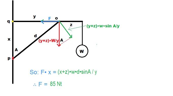

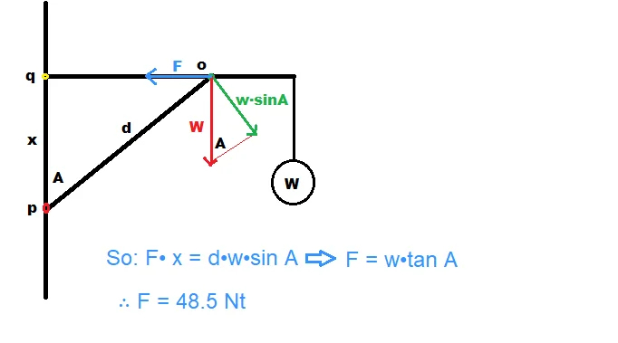

Isn't this the proper resolution of forces for the torque about pt P?
Free-body diagram of a rod pivoting at o, hung from a vertical wall at q and tied by a diagonal cable to point p, with weight W hanging from its right end, showing forces F, W and w sinA and the equation F = w tan A.
Which is the same result as when you applied a free body analysis to point "o".
BTW, There is only a perpendicular force to the wall at point "q" by virtue of the initial conditions.
Fy=0
Edit: Fy is not zero due to the torque about point "o". See correction in post 100.
Fy=0
How come you have relocated W to act at point O?
The horizontal distance from P to the hanging mass is what matters.

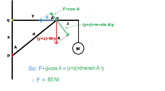

Yes., thanks, My revised diagram is
Hand-drawn diagram of a vertical wall with points p and q, a horizontal rod meeting a diagonal strut d at point o, a hanging weight W from the rod's end, and labelled forces F and (y+z)W/y at angle A, with the equation F d cos A = (y+z) d w sin A / y and F = 85 Nt.
  • Diagram of a bar hinged at a vertical wall point with a horizontal force F acting at one end, a weight W hanging from the far end, and a diagonal strut from the wall to the hinge; labels include x, y, z, d, A, p, q and the moment equation F x = (x+z) w d sinA / y.
That gives the right moments equation, but it is not right as a force diagram. The weight W, applied where it is, is not equivalent to a greater force applied at O.
Why not consider the horizontal bar and the diagonal bar as the system and just write ##(y+z)W=xF##?
haruspex said:
Why not consider the horizontal bar and the diagonal bar as the system and just write (y+z)W=xF?
This is the simplest approach to get what is asked (F) and is also used in the solution in the OP.
But it seems like some posters want to go beyond that, and solve for all force components at all connections. However, the original diagram is just specific enough to get what is asked, so we get different interpretations and results for the other components.
That is the way it is solved in the OP. I thought it instructive to determine the force at pt "o' since the lever arm at point "p" is d. It may not be obvious that W•(y+z) is correct since W is not at "o" like F is.
Ok, but the force at point O due to the suspended weight is W, as you had it in post #98. The error there is that, since the horizontal bar is rigid, there is also a torque ##Wz##. I.e. the force of the weight acting at the end of the bar is equivalent to W acting at O plus a clockwise torque ##Wz## about O.
