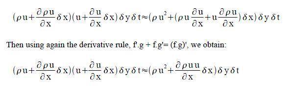

Heya,
I can expand the term on the LHs and get the term on the RHS no problem :)
But,
I don't understand how the bottom line is arrived at; I think its basically just a backward engineering of the product rule, but I can't get it!
Any help would be useful
[tex]\frac{\partial(\rho u u)}{\partial x} = \rho u \frac{\partial u}{\partial x} + u \frac{\partial (\rho u)}{\partial x}.[/tex]
