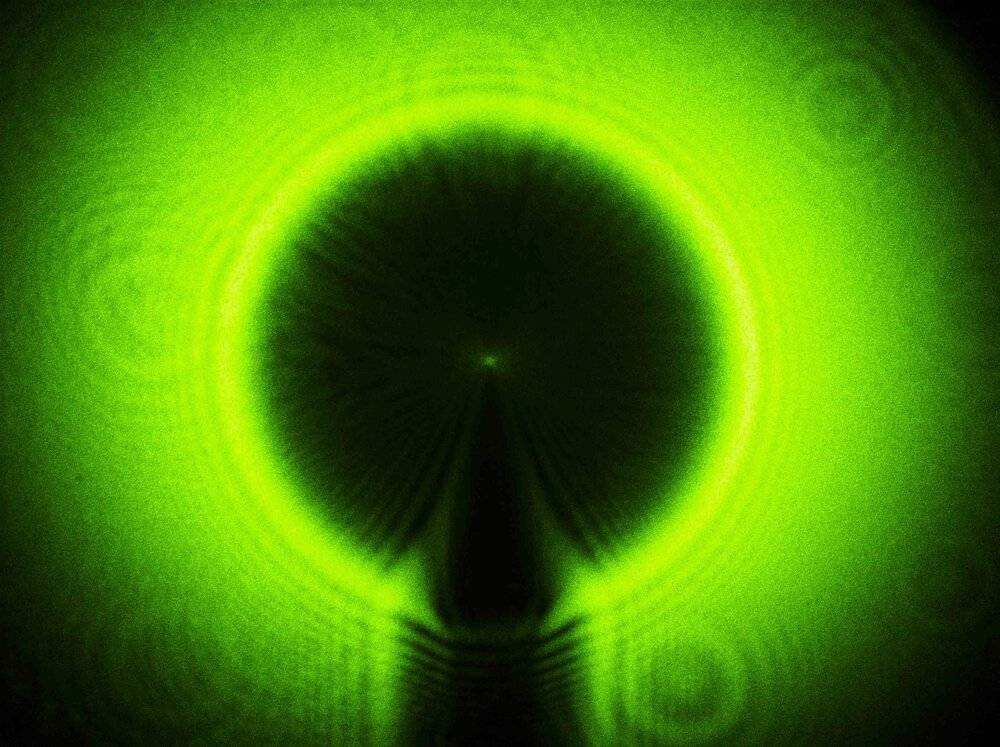

Why is there a bright spot at its center? Thanks?
non
A point source of monochromatic light is placed in front of a soccer ball and a screen is placed behind the ball. The light intensity pattern on the screen is best described as:
Answer: a dark disk with a bright spot at its center and bright rings outside
That's Arago's spot. You get constructive interference from the diffracted rays at the edge of the sphere.
On edit: Here is what I consider a better picture than the Wikipedia article of a steel ball-bearing standing on a steel rod. The photo was taken with a green laser.
I got it! Thank you.
