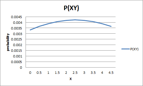

Suppose I have observed ##Z = 3##, where ##Z = X + Y##, where ##X \sim N(0,9), Y \sim N(0,4)##. How would I find the most probable value of ##X## that would have given me ##Z = 3##?

My first instinct is to say that the most likely value of y is 0, so x, having larger standard deviation would be more likely to be 3. However, ##p(x=3 \cap y=0) =.033##. Slightly higher values of y will likely optimize this function.

Look at
[tex]f(x|z) \equiv \lim_{\Delta x \to 0, \Delta z \to 0} P(x < X < x + \Delta x\,| z < Z < z + \Delta z)\\<br /> = \lim_{\Delta x \to 0, \Delta z \to 0} \frac{P(x < X < x + \Delta x \: \cap \: z < Z < z + \Delta z)}{P(z < Z < z + \Delta z)}[/tex]
For ##z = 3## this will give you
[tex]c \, f_X(x) f_Y(3-x)[/tex]
where ##c## is a normalization constant. For what value of ##x## would that be maximized?
