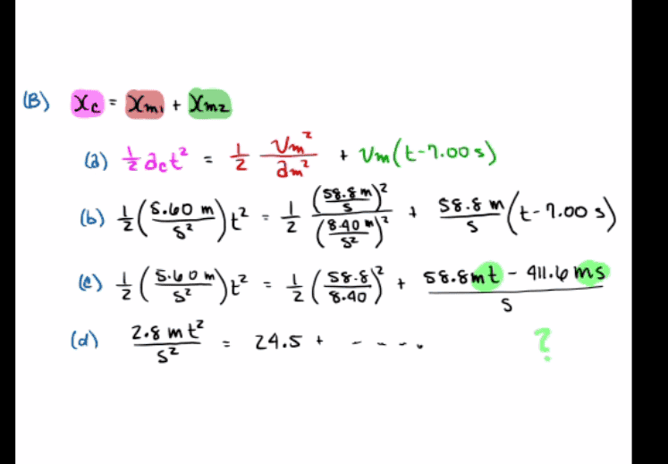

Now the text says that this is a quadratic, and obviously we need to solve for ##t##.
Now if you'll look at my attached image, you can see what a disaster I am making of this. We want ##t##, but there are also seconds in the equations. I'd imagine the meters should cancel.
Please help :cry:
  • Handwritten working on a physics problem: part (B) sets xc = xm1 + xm2, then parts (a) to (d) substitute numbers, ending with 2.8 m t^2/s^2 = 24.5 + ... and a question mark.
The ##a_m## in the denominator of the first term on the right should not be squared in your hand-written notes.
I'm not sure what difficulty you are having with the units of the last term on the right. It looks good. ##(58.8 \rm m)t## has units of meters multiplied by seconds. Also, the ##411.6 \, \rm {m \cdot s}## has units of meters multiplied by seconds. Both of these quantities are divided by seconds, so overall they yield meters. This is as it should be since the terms in the starting equation represent distances.

(58.8m)t(58.8 \rm m)t has units of meters multiplied by seconds
I guess this part is the root of my troubles. Yes, ##t## is measured in seconds, but it's still the variable ##t## which I'm solving for.
TSny said:
Also, the 411.6m⋅s411.6 \, \rm {m \cdot s} has units of meters multiplied by seconds.
This one is what makes more sense and I can clearly see the seconds cancel, but the seconds is a unit, and the ##t## in the other term is a variable.
Take a very simple example. Suppose a car moves at a constant speed v = 2 m/s. To find the time it takes the car to travel 10 m, you could set up the equation x = vt as
##10 \, m = (2 \, m/s) t##
Do the units bother you here? Yes, t is a variable. But it is a variable that has units of seconds.
If you solve the above equation for the time t, you get
##t = \frac {10\, m}{ 2 \, m/s}##
You can see that the units in the answer for t reduce to seconds. m cancels and the s comes up to the numerator.

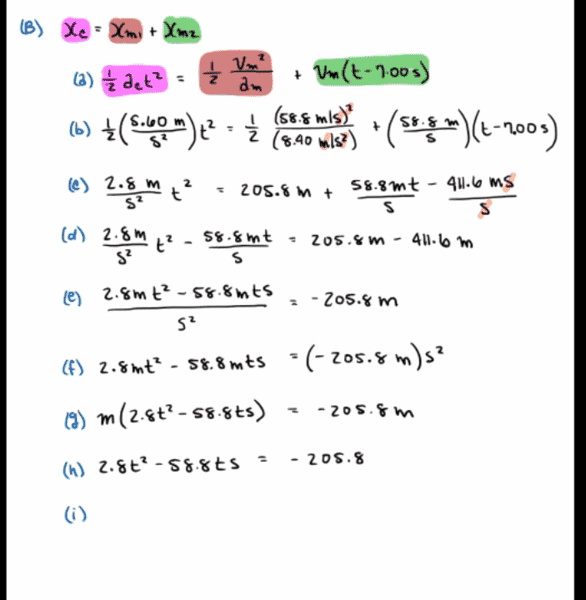

Ok, I'm almost entirely on board with you and I'm almost there. I'm having troubles actually isolating the ##t##. Can you spot any errors?
In going from (f) to (g) you dropped ##s^2## in the term on the right side. So (h) is missing units of ##s^2## in the term on the right. Move this term to the left so that you have zero on the right. You can then solve for t using the quadratic formula. I would express the term with the 58.8 as (58.8 s) t.
Drats. Thanks! Ok and one final question (apologies if these are off the mark. I haven't done this kind of stuff yet).
With the a,b,c for the quadratic formula,
would ##b=-58.8ts## or would it be ##b=58.8t##? Similarly, ##c=205.8## or ##c=205.8s^2##? A dumb question I know, but I don't want to start throwing units out if it's not appropriate and then be left with bad problem solving habits.
To be more clear,
##x=\frac{{58.8s+-\sqrt\{(58.8s)^2-4(2.8)(205.8s^2)}}{2(2.8)}## ??
opus said:
To be more clear,
Yes. Looks good. Of course the x on the left is actually t.

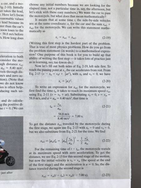

I guess I don't understand why we say that ##x_{m1}=\frac{1}{2}a_mt_m^2=\frac{1}{2}\frac{v_m^2}{a_m}##
Rather than ##x_{m1}=\frac{1}{2}\frac{8.40m}{s^2}{7.00s^2}## The text went directly out of it's way to not use the 7 seconds that we found for ##x_{m1}##
So that we’re reading from the same sheet of music.
  • Photo of a printed textbook page showing kinematics derivation with equations 2-19 through 2-23, including x = x_m1 + x_m2, x = (1/2)a_m t^2, t_m = v_m/a_m = 7.00 s, and x_m2 = v_m(t - t_m) = v_m(t - 7.00 s).
Although it deals with cars and motorcycles, that's a fairly pedestrian approach if you ask me!
