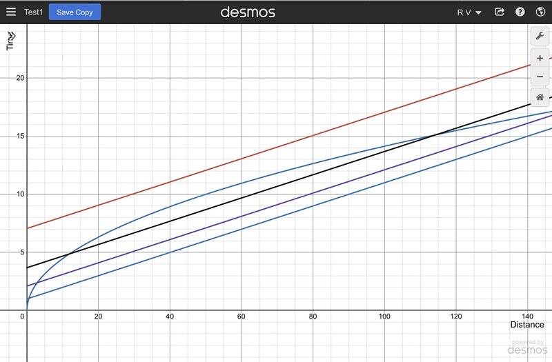

I don't know , maybe you have a look at this. I get a formula for ##t_n## that is how long it takes the bird to get to the train and is a constant to the nth power ## \propto (1 - 2q)^n ##. I find that ##q## ( a constant of speed parameters) is less than ##\frac{1}{2}## so long as the velocity of the bird does not equal that of the train (which would result in a single collision).
Then I sum double all these ##t_i## and I should have a geometric series sum. That has to be finite in ##n## right, because the sum must be equal to ## \frac{V_T}{S_o} ## ?
The way I see it if ##v_B = v_T## we get 1 collision. They meet at some point (the middle) and they never separate. I think this proves that if the train is slower than the bird there will be more than 1 collisions, but a finite number.
But I might be goofing up, because I also had the same thought as you until I got half way to a possibly erroneous result. Or my result is fine, and I'm doing a muck up of its interpretation. I'm going to have to work on it.
@bob012345 I think you are correct. When I think about what happens when the bird is even just a little bit faster than the train, I see what you are saying. It would always reach a point over half-way of the distance between them at the beginning of the trip out to meet the train, and it seems there will always be a trip out to the train! Its does seem to be Zeno's Bird!
Just a 1 one second pause takes you from infinite to finite number of collisions! How about a ##0. \cdots 000001## pause?

Fwiw, I worked in terms of ##v_n##, the velocity of the train at completion of the nth cycle, and obtained a quadratic in ##v_n, v_{n+1}## and constants. The quadratic is quite general, involving the cross product and linear terms with different coefficients.
I should verify it against @erobz' numeric result.
