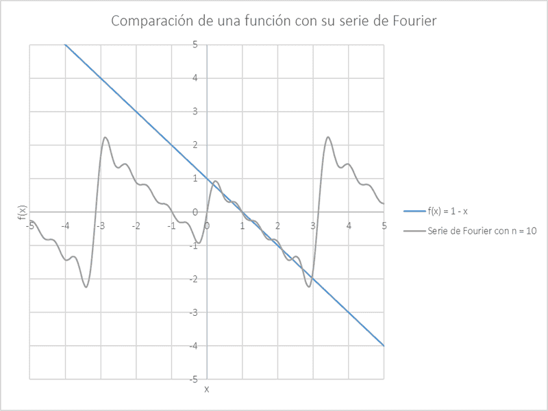

I am currently learning Fourier series (and then we'll move on to the Fourier transform) in one of my courses, and I'm having a hard time finding motivation for its uses. Or, in other words, I can't seem to find its usefulness yet. I know one of its uses is to solve the heat equation, which is why we're learning Fourier series in the first place, but aside from that, other applications are not so evident. Now, I'm not trying to disregard Fourier series as a useful mathematical tool, I'm actually really interested in mastering this technique and the Fourier transform, I just need help in order to see the whole picture.
For example: most textbooks, when presenting the technique, state that it is a useful tool for expressing a periodic function as a sum of sines and/or cosines, and should only be used on periodic functions. What is the point of this, if the function is already, by definition, periodic?
Then, one of my exercises asks to find the Fourier sine series of [itex]f(x) = 1 - x[/itex] for the interval [itex][0,\pi][/itex], which is
[tex]f(x) = \frac{2}{\pi} \sum_{n=1}^{\infty} \frac{1-(-1)^n+\pi(-1)^n}{n} \ \sin{nx}[/tex]
I plotted the results in order to see what is actually going on.
As you can see, the series approximate the function the most between 0 and [itex]\pi[/itex] (roughly). It seems obvious that the series will approximate the function only for the given interval, is this the rule? Now, regarding this same example, what would be the point of having a function like this and obtain its Fourier series, application-wise? What can you do with it?
Regarding the Fourier transform, what I understand is that you can use it to obtain a series for a function, but for the entire real domain, that is [itex](-\infty,\infty)[/itex]. However, this impression might be wrong, as it also changes the independent variable, which doesn't happen when you obtain the Fourier series of the function. Speaking of which; I understand that when your independent variable is time, the Fourier transform takes you into the frequency domain. But, what happens when the independent variable is x, as in position? What is the physical meaning of the variable change?
Thanks in advance for any input, I tried to be as clear as possible, which I hope I did! :smile:

As you can see, the series approximate the function the most between 0 and π\pi (roughly). It seems obvious that the series will approximate the function only for the given interval, is this the rule?
Yes. By definition a Fourier series approximates a periodic function.

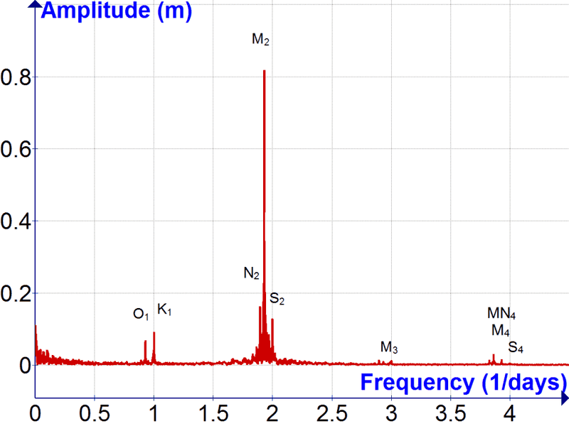

From my point of view, there is a sum of oscillating components hiding in a lot of measurements, and the Fourier transform is the optimal tool for accurately determining the amplitude, frequency, and phase of each of those oscillating components. For example, the attached figure shows a Fourier transform of measured water levels over a year. All the frequency components that make up the tides can be discerned, along with their frequencies and amplitudes.
See: https://arxiv.org/pdf/1507.01832v1.pdf

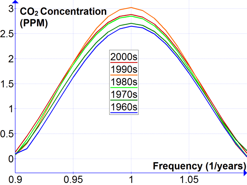

In other cases, the frequency of an oscillation may be known, but a more precise measurement of its amplitude might be of interest. Everyone knows about the annual ripple in the Mauna Loa CO2 measurements. The period is exactly one year. But the attached figure shows that the amplitude of that oscillation is changing over the decades, suggesting as CO2 levels rise, the amount of carbon cycled into the biomass each year is also increasing.
See Fig 4 of: https://arxiv.org/pdf/1507.01832v1.pdf
Lots of practical examples of Fourier transform usefulness in the linked paper.

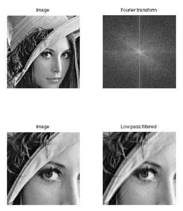

An application of the Fourier series which I find very interesting is compression of data. Consider a digital picture, W pixels wide and H pixels high. A digital picture is often composed of three components - red, green and blue. By letting the brightness of each pixel represent the value of a function at each point, we can simply invoke the power of Fourier analysis and decompose this picture into frequency components. The number of frequency components stored directly affects the quality of the reconstructed picture, and this technique lays the foundation of the widely used JPEG standard. This is applicable to any set of data

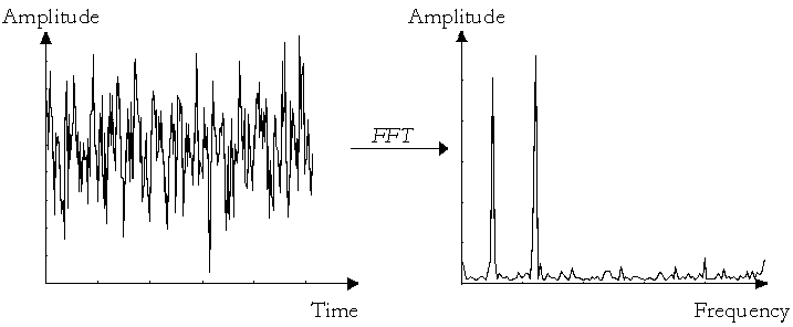

Also, because the atmospheric attenuation of signals is different for different frequencies, only a limited range of frequencies can be used. Although a gross oversimplification, almost all of these examples have common elements, and not just the Fourier transform. From an engineering perspective, they are all examples of systems that take some input and gives some output. And in all these cases, the output is frequency dependent.
Put a pendulum in motion, measure the length of the string and observe the frequency of oscillation. This tells you about the mass of the pendulum.
Put a sinusoidal sound signal on a speaker and record it from the other side of a wall. Vary the frequencies and measure the attentuation of the sounds for each frequency. Now, play a song and listen to how the sound is muffled. Then, take a sample of the song, perform a Fourier transform of the song, multiply it by the frequency spectrum you have found, then transform back to the time domain. You will most likely hear the same muffled sound, but coming directly from your speaker.
