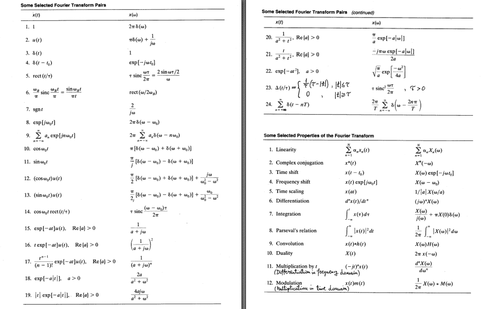

I am looking for a way to calculate w-derivative of Fourier transform,d/dw (F{x(t)}), in terms of regular Fourier transform,X(w)=F{x(t)}.
Definition Based Solution (not good enough):
from
25905b02d53ae042b113c038d50ac131fcf020d0
I can find that w-derivative of Fourier transform for x(t) is Fourier transform of t*x(t) multiplied by -j:
d/dw (F{x(t)})=d/dw(X(w))=-j*F{t*x(t)}Question:
But, taking into account the differentiation and duality properties of Fourier transform:
is it possible to express the derivative, d/dw (F{x(t)}), in frequency domain using terms of X(w) ?
