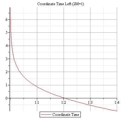

In "Gravitation" - Misner, Thorne, Wheeler, the second part of formula 25.38 (first part describes the proper time left till the singularity) seems to suggest it describes some kind of coordinate time left. But the question is what exactly?
Here is the formula:
[tex] t={\it 2M}\, \left( -2/3\, \left( {\frac {r}{{\it 2M}}} \right) ^{3/2}<br /> -2\,\sqrt {{\frac {r}{{\it 2M}}}}+\ln \left( \left( \sqrt {{\frac {r<br /> }{{\it 2M}}}}+1 \right) \left( \sqrt {{\frac {r}{{\it 2M}}}}-1<br /> \right) ^{-1} \right) \right) [/tex]
Now this seems to behave well but not close to 2M. For instance if we graph for 2M=1 we get:
Time left actually becomes zero at around 1.203325645.
Perhaps I am doing something wrong or is there a good explanation?

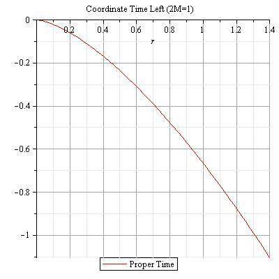

For comparison proper time left:
Take a look at Fig. 25.5 (on the same page as equation 25.38 in my edition of MTW). It should make clearer the meaning of the equations for proper time and coordinate time. The only difference in equation 25.38 is that the zero of proper time is set at the instant when the infalling object reaches r = 0, which would correspond to moving the vertical axis in Fig. 25.5 to the right to the point where the proper time curve intersects r = 0.

Sorry if I wasn't clear. I didn't mean that equation 25.38 was used in the graph directly; I meant that if you take the vertical axis of the graph (which is time, either proper or coordinate) and move it rightward so it crosses the horizontal axis (which is radial coordinate r) at the point where the proper time curve intersects it, you have a graph which basically illustrates equation 25.38, both parts.
Passionflower said:
Where does 1.203325645 come from for 2M=1 and t=0? Can you help?
It's just another illustration of the fact that, while it only takes a finite amount of proper time for the falling object to reach r = 0, the falling object never even reaches the horizon at any finite value of coordinate time. In this particular case, the numerical value you obtained could be physically interpreted as follows: put two observers out at r = infinity, and have one fall towards the black hole while the other remains stationary at r = infinity. They both set their clocks to t = minus infinity when the first observer starts to fall. The first observer's clock will read zero just as he hits the singularity at r = 0. When the second observer's clock reads zero, he will "observe" the first observer to be at an r-coordinate of 1.203325645 (assuming 2M = 1). Even as the second observer's clock goes to plus infinity, he will never "observe" the first observer reaching the horizon at r = 1.
(I put "observe" in quotes because to actually define the second observer's "observing" procedure operationally requires care; but basically it means the second observer, after making all measurements and applying all necessary corrections for light travel time, etc., etc., would assign the given r-coordinate to the first observer at the particular t-coordinate corresponding to the given reading on his clock.)

As PAllen said, this is correct, but as MTW note in the text, the physics of the problem is essentially independent of the particular radius at which the object starts falling (they use a capital R for this radius). So they basically take the limit as R -> infinity to obtain equations 25.38; nothing essential is changed, and the graph is still a reasonable representation of what's going on. If you want to be precise, imagine both curves on the graph (with the vertical axis relocated as I described) going out to negative infinity, and increasing vertically without bound as they do; once you get out to large enough negative values, the two graphs basically coincide, so nothing interesting is going on.

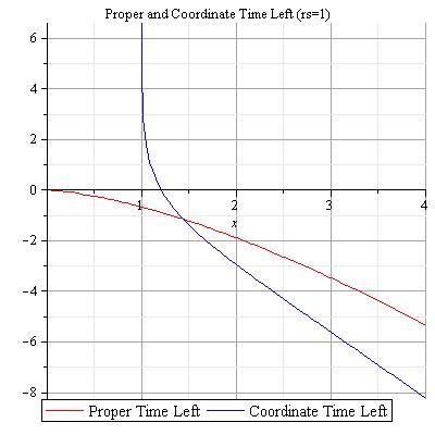

Here is a graph showing both parts of 25.38 for rs=1
By the way the crossing point is: r=1.439228840
Which is obviously another question, what does it represent?
So we got r=1.203325645 for t=0 and r=1.439228840 for t=tau
When the proper time left is 3/2 the free falling observer reaches the EH and correspondingly the coordinate time is positive infinity.
So does it not seem that when the coordinate time is 0 the free falling observer has not yet reached the EH? On the graph when the coordinate time is zero the proper time left corresponds with -0.8800016760.
It seems I still do not understand what Peter says.

From your picture (apparently for M=1), proper time of -2/3 corresponds to arrival at the event horizon, proper time zero is the singularity; all this is the aim of the 25.38. The coordinate time at the horizon is positive infinity, as expected, since an outside observer (for whom the given coordinates represent) never sees matter cross the event horizon.
As for relating coordinate time zero for an outside observer to proper time for an infalling observer, personally, I don't view this as having any real physical meaning. Perhaps one can come up with something, but to me the key points are proper time for crossing the event horizon and the singularity, and the asymptotic behavior of coordinate time for an outside observer. All else can be changed at will by arbitrary conventions.

Yes, this is correct. But instead of "proper time left is 3/2", I would say "proper time = - 3/2" . In other words, the event where the infalling observer crosses the horizon has proper time = - 3/2 but coordinate time positive infinity. So at the given value of r you've calculated, where the coordinate time is 0, the proper time for the infalling observer is something *less* (more negative) than - 3/2. And yes, at this point (meaning, at the event with these coordinates) the infalling observer has not yet crossed the horizon. We could quickly summarize what I've just said as follows, using r for the radius, t for coordinate time, and T for proper time (and assuming 2M = 1):
Event A: "Coordinate time zero", has coordinates r = 1.203325645, t = 0, T < - 3/2 (I can't remember if the exact value has been calculated in this thread).
Event B: "Infalling observer crosses the horizon", has coordinates r = 1, t = + infinity, T = - 3/2.
Event C: "Infalling observer hits the singularity", has coordinates r = 0, t undefined, T = 0.
Note that t, coordinate time, is undefined for event C, because there is a coordinate singularity with Schwarzschild coordinates at r = 2M; the metric coefficient [itex]g_{rr} = \left( 1 - 2M / r \right)^{-1}[/itex] has a "divide by zero error". Technically, this means the coordinate time of Event B is undefined as well, but it seems to be common to state it as + infinity to get across the idea that the observer far away never sees the infalling observer reach the horizon.
All this is just a manifestation of the curvature of the spacetime; coordinate time corresponds to the time experienced by an observer who remains far away from the black hole, whereas the proper time here is the time experienced by the infalling observer. As the latter gets closer to the horizon, the divergence between his experienced time and the time experienced by the observer far away increases, ultimately to infinity when the infalling observer crosses the horizon.

And - yes- coordinates do have little physical significance. People can, and do, use all sorts of coordinates to describe black holes. Off the top of my head there are Schwarzschild coordinates, isotropic coordinates, Painleve coordinates, Novikov coordinates, Kruskal-Szerkes coordinates, and Edington-Finklestein coordinates. So the specific coordinate numbers you assign to an event is a matter of convention. Every coordinate system is a "map" of space-time, but the specific numbers you use to label the map are conventional, not physical.
In particular, coordinates, such as the Schwarzschild R coordinate, do _not_ in general represent any sort of physical distance. I'm not sure if you were reading any of the discussion about what distance was in GR or not. A really quick rehash: in relativity, space and time are mixed together, therefore to define distances, one needs to define simultaneity. I'm sure I've made this point before, and I don't want to beat it to death - I don't think you've ever responded to the point.
Right as yuiop correctly indicated the proper time at r=1 for rs=1 is -2/3 (not -3/2).
For Event A we get:
Event A: "Coordinate time zero", has coordinates r = 1.203325645, t = 0, T = -0.8800016760
Ok, I finally am getting it as only the difference between two coordinate values have relevance not the absolute value.
I found a related covering of this topic at: http://www.mathpages.com/home/kmath375/kmath375.htm
Thanks everybody for taking the time, it is clear to me now.
