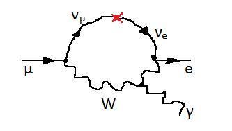

I was doing an exercise with the decay: [itex]\mu \rightarrow e \gamma[/itex]
which violates the lepton number but it is (in principle) allowed due to neutrinos interactions.
The exercise asked to approach the problem with the HUP and find the time interval and "distance" traveled by the intermediate neutrinos, and compare it to the km scale of neutrino oscillations.
[itex]L= c \Delta t = \frac{\hbar c}{2 M_W} \sim 10^{-21}~ km[/itex]
Obviously very small...
I was wondering if anyone knows a way that uses the normal derivation for the probability of this interaction. In particular I am not sure I know how to use the fermion propagator lines for the neutrinos when at some point there is a flavor change.
I think experimentally the Branching ratio has been found to be less that ##0.57 \times 10^{-12}##

However I don't know how to express a diagram that looks like this:
  • Feynman diagram of a muon decaying to an electron and a photon via a W boson loop, with a muon neutrino (labelled v_mu) and an electron neutrino (labelled v_e) in the loop, and a red cross marking a neutrino mass insertion on the internal neutrino line.
What do you mean with "express"?
Calculate properly? That takes much more effort, and where is the point? Not even the experts bother calculating this more precise than the order of magnitude (sometimes not even that).
Well not calculate if it's so bothersome. Just trying to see how to write the terms in the propagator... (especially for the neutrino transition).
Someone should correct me if I'm wrong because I'm not too familiar with this, but I think the neutrino line can be written
[tex]\sum_{i=1}^3 U_{\mu,i} \frac{1}{p_\mu \gamma^\mu - m_i} (U_{e,i})^*[/tex]
where ##U## is the PMNS matrix and ##i## labels the neutrino mass eigenstates.
Note that if all the ##m_i##'s are equal, then the overall expression is proportional to ##\sum_i U_{\mu,i} (U_{e,i})^*## which is zero because it is an off-diagonal element of ##U U^\dagger= I##. So the amplitude is going to end up proportional to a difference of neutrino masses, or probably a difference of squared masses.
If you expand the above expression as a power series in the masses ##m_i##, then I think the first order term is
[tex]\frac{1}{p_\mu \gamma^\mu}\left(\sum_{i=1}^3 m_i U_{\mu,i} (U_{e,i})^*\right) \frac{1}{p_\nu \gamma^\nu}[/tex]
This corresponds to how your diagram is drawn. There is a massless propagator for the electron neutrino, a massless propagator for the muon neutrino, and an insertion of the neutrino mass matrix which produces the ##\nu_\mu \to \nu_e## transition. Now we are treating the neutrino masses as perturbations; they lead to vertices like your red X at which we should insert the central expression in parentheses above.
Actually you can't do that, because each of the vertices with the W boson and the neutrio have a $$P_L$$ projector, so if there's no masses you have
$$\gamma^{\mu} P_L \not p \not p \gamma^{\nu} P_L $$
which is zero, as the P_L ...P_L -> (...) P_R P_L
So the masses are necessary in the propagators too. Basically you have to expand it out to a higher order than what you have.
So not only is it suppressed by the mass insertion, but additionally because of the dirac structure of the currents, only mass-proportinoal terms survive. So this will go like m^2 at the amplitude level.
