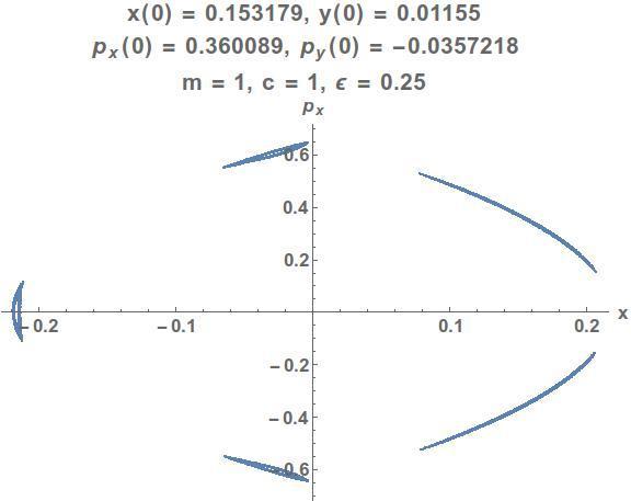

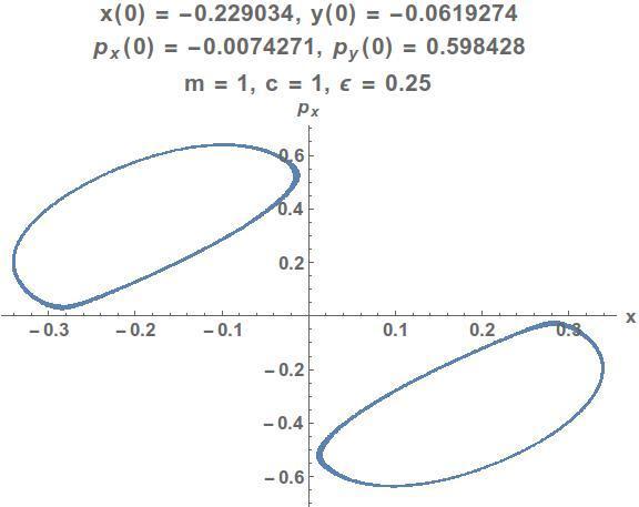

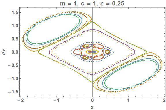

Here are some poincare plots I created when y = 0 and p_y > 0:
Can you conclude anything from these plots?
There do seem to be in tact tori. But I like to let the integrations run longer so the points fill out the tori more fully.

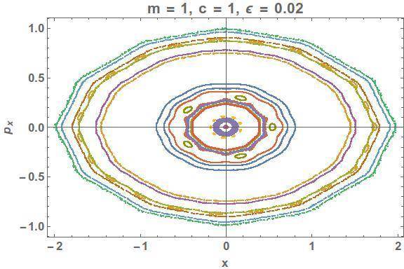

I ran the integrations for 100 times longer than the previous plots and here are the results:
How can I find the other constant of the motion?

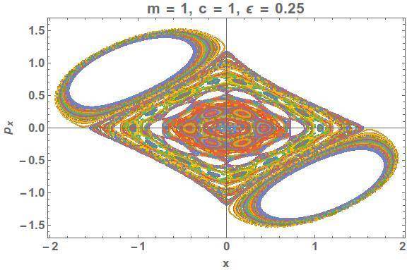

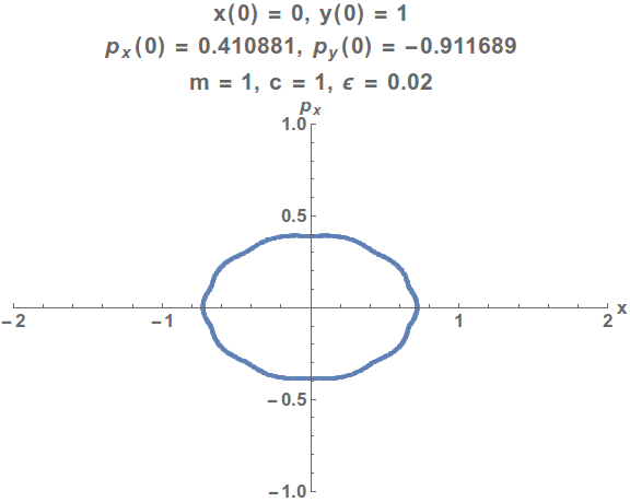

I did 20 different trajectories with x(0) = 0, y(0) = 1 with p_x^2 + p_y^2 = 1:
Dr. Courtney said:
You approach is fine, but be aware that the nature of the dynamics likely changes with the energy.
I usually pick one energy to study at a time. Sweeping the initial momentum through the angles usually samples a representative portion of the phase space available at that given energy and generates informative Poincare plots.
The potential that I am studying is a homogeneous function, so we can use mechanical similarity, so I think studying one energy is enough.
That's pretty good work in such a short time with so little guidance.
One way to proceed from here would be to go ahead and compute (a numerical approximation for)
\langle p_x^2 \rangle = \lim_{T \rightarrow \infty} \frac{1}{T} \int_0^T dt p_x^2 (t)
\langle p_y^2 \rangle = \lim_{T \rightarrow \infty} \frac{1}{T} \int_0^T dt p_y^2 (t).
for each of the tori shown in the figure. You approximations will be most accurate if you end the integration from about the same place on the torus as you start it from. As T goes to infinity, the trajectory will just keep winding around the torus, so the more accurate estimates will be one that samples different parts of the torus evenly.

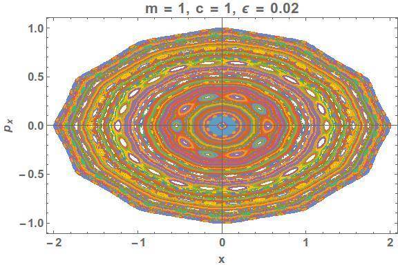

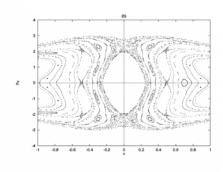

I created the same plots for epsilon = 0.02, I have some numerical issues trying to reduce epsilon even more as it gets more difficult keeping the energy "constant" (within some reasonable amount of error).
It does seem to get simpler as you expected!
Great stuff. I think the outermost ring may be an ergotic region between two tori and not really be a tori itself. This may also be true for some of the inner rings.
//I created the same plots for epsilon = 0.02, I have some numerical issues trying to reduce epsilon even more as it gets more difficult keeping the energy "constant" (within some reasonable amount of error).//
Cases like this are where I've found Runge-Kutta with variable step size to be useful. Running the code in C was fairly fast, even on the 80386 with 4 MB RAM that I used back in the early 90s. I was living large when I bought by first Pentium. The ThinkPad on my lap these days blasts through all these.
