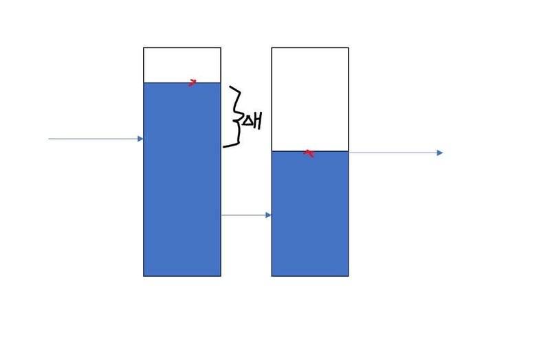

There are two interconnected tanks. Tank 1 having higher water level compare with Tank 2. The connecting pipe lowering the level to align the water level of two tanks and decrease the water level difference. Can you tell me why changing the connection pipe height can change the water level difference?

Can you provide a drawing? Because from how I understand it now the premise is false (the height of the connection pipe will not influence the ultimate height difference between the tanks, which will be zero unless one of the connection points 'runs dry'.

here is the picture connection pipe in middle of two tanks. how does it influence the changes of delta H?

Its only has effect in the transient behavior.
so, connection pipe level fluctuations doesn’t affect the water level difference?
Where you put the pipe and its size matter for the transient response i.e. how ##\delta h ## changes in time. There is going to be some decaying fluctuation curve that may have absolute differences ( but similar "shape" responses )
sorry to mention one more information, 1st tank from left side of picture has less volume size than the 2nd tank in right side. does it a factor?
The height difference is what is the relevant driver. The ratio of tank areas comes into play as well for the transient behavior.
Are you trying to determine ##\delta h (t)## given an initial state (a closed valve in the pipe)? Or are you just trying to figure out at what height the system tends to (the steady state response)?
It seems that external water is coming into left tank and water is overflowing right tank?

Thats a good point. What are those arrows indicating entering and exiting tank A and B. I may be jumping the gun on believing the OP is accurately describing "the actual system" given that diagram.

Try putting the connecting pipe just below the level of the water shown for the tank on the left.

do you think that the connection pipe level may affect the water level difference between two tanks?
there is no valve between two tanks

Then you aren't telling us the whole story. If there is no valve than this system is being maintained at these levels by an incoming flow on the left tank, and an outgoing flow in the right tank.

right just by gravitational flow
If the tanks are being maintained at the current levels what does that imply for the volumetric flowrate entering tank A and exiting tank B?
inflow rate in tank A is higher than the outflow rate in tank B
Is the volume of liquid in either tank changing over time?
