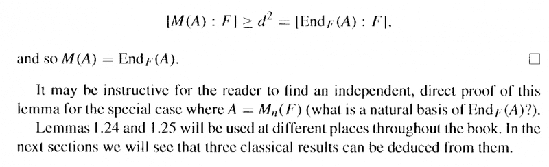

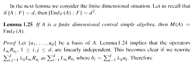

I am reading Matej Bresar's book, "Introduction to Noncommutative Algebra" and am currently focussed on Chapter 1: Finite Dimensional Division Algebras ... ...
I need help with the proof of Lemma 1.25 ...
Lemma 1.25 reads as follows:
My questions on the proof of Lemma 1.25 are as follows:Question 1
In the above text from Bresar we read the following:
" ... ... Therefore ##[ M(A) \ : \ F ] \ge d^2 = [ \text{ End}_F (A) \ : \ F ]## ... ... "Can someone please explain exactly why Bresar is concluding that ##[ M(A) \ : \ F ] \ge d^2## ... ... ?Question 2
and so ##M(A) = [ \text{ End}_F (A) \ : \ F ]##. ... ... "Can someone please explain exactly why ##[ M(A) \ : \ F ] \ge d^2 = [ \text{ End}_F (A) \ : \ F ]## ... ...
... implies that ... ##M(A) = [ \text{ End}_F (A) \ : \ F ]## ...
Hope someone can help ...
Peter

Math Amateur said:
Question 1
We know that ##M(A) = \langle L_a , R_b \,\vert \, a,b \in A \rangle ## is generated by left- and right-multiplications by definition.
Lemma 1.24 guarantees us that ##\{L_{u_i} \cdot R_{u_j} = L_{u_i} \circ R_{u_j}\,\vert \, 1 \leq i,j \leq d \}## are linear independent ##^{*})##. These are ##d^2## many, so the dimension of ##M(A)## can only be greater than ##d^2##, because we already have found ##d^2## linear independent vectors, which can be extended to a basis.
##^{*}) \; 0 = \sum \lambda_{ij}L_{u_i}R_{u_j} = \sum L_{u_i} R_{b_i} \Longrightarrow ## (Lemma 1.24) ## b_i = \sum \lambda_{ij}u_j = 0 \Longrightarrow \lambda_{ij}=0## because ##\{u_k\}## is a basis, hence ##L_{u_i}R_{u_j} = L_{u_i} \cdot R_{u_j} = L_{u_i} \circ R_{u_j}## are linear independent.
Question 2
Well, ##L_a## as well as ##R_b## are endomorphisms of ##A##, i.e. ##\mathbb{F}-##linear mappings ##A \rightarrow A##.
Therefore ##M(A) \subseteq End_\mathbb{F}(A)## and we have a subspace ##M(A)## which has at least dimension ##d^2##. On the other hand ##End_\mathbb{F}(A)## has exactly the dimension ##d^2##, so there is no room left between ##M(A)## and ##End_\mathbb{F}(A)##.
That ## \dim End_\mathbb{F}(A)=d^2 ## can fastest be seen, if we think of matrices: Since ##\{u_1,\ldots, u_d\}## is a basis of ##A##, all linear functions, i.e. every element of ##End_\mathbb{F}(A)## can be written as a ##(d \times d)-##matrix with respect to this basis.

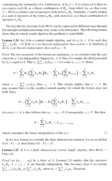

But just a clarification ... You write:
" ... ... Lemma 1.24 guarantees us that ##\{L_{u_i} \cdot R_{u_j} = L_{u_i} \circ R_{u_j}\,\vert \, 1 \leq i,j \leq d \}## are linear independent ##^{*})##. "What do you mean when you write " ##L_{u_i} \cdot R_{u_j} = L_{u_i} \circ R_{u_j}## " ...
There appear to be two "multiplications" involved, namely ##\cdot## and ##\circ## ... but what are these ...?
and, further what is the meaning and significance of the equality " ##L_{u_i} \cdot R_{u_j} = L_{u_i} \circ R_{u_j}## "
Can you help ...Still reflecting on your post ...
Peter
I simply wanted to indicate, that multiplication ##"\cdot"## here is the successive application of mappings ##"\circ"##, no matter how it is written even if without multiplication sign. In the end it is ##(L_{u_i}R_{u_j})(x) = L_{u_i}(R_{u_j}(x))=L_{u_i}(x\cdot u_j) = u_i \cdot x \cdot u_j##.

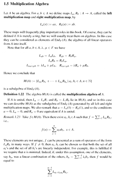

" ... ... We know that ##M(A) = \langle L_a , R_b \,\vert \, a,b \in A \rangle ## is generated by left- and right-multiplications by definition. ... ... "Now ... if ##M(A)## is generated by ##L_a## and ##R_b## then it should contain elements like ##L_a L_b L_c## and ##L_a^2 R_b^2 R_c## ... and so on ...BUT ... how do elements like these fit with Bresar's definition of ##M(A)## ... as follows:
##M(A) := \{ L_{a_1} R_{b_2} + \ ... \ ... \ + L_{a_1} R_{b_2} \ | \ a_i, b_i \in A, n \in \mathbb{N} \}##
... ... unless ... we treat ##L_a L_b L_c = L_{abc} R_1 = L_t R_u##
where ##t = abc## and ##u = 1## ... ...and ##t, u \in A## ... ...
... and ...
we treat ##L_a^2 R_b^2 R_c = L_{aa} R_{cbb} = L_r R_s##
where ##r = aa## and ##s = cbb## ...Can you help me to clarify this issue ...
Peter
But also, #10 is almost immediate from the definitions of Ls and Rt:
(La Lb) x = (LaoLb) x​
= La (Lb x)​
= La (bx)​
= a(bx)​
= (ab)x​
= Lab x.
And virtually the same reasoning to show
(Rc Rd) x = Rdc x.​
(Also note that, any La and any Rb commute:
La Rb = Rb La.​
This can be proved in a similar manner.)
