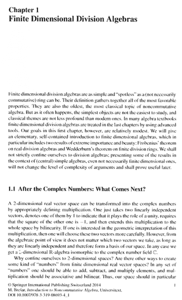

I am reading Matej Bresar's book, "Introduction to Noncommutative Algebra" and am currently focussed on Chapter 1: Finite Dimensional Division Algebras ... ...
I need help with understanding some remarks that Matej Bresar makes in Chapter 1 ...
The relevant text is as follows:

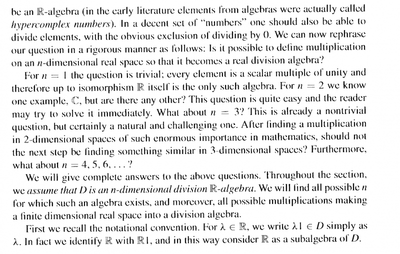

In the above text from Bresar we read the following:
" ... ... Is it possible to define multiplication on an ##n##-dimensional real space so that it becomes a real division algebra?
For n = 1 the question is trivial; every element is a scalar multiple of unity and therefore up to an isomorphism ##\mathbb{R}## itself is the only such algebra. ... ... "How do we know exactly (rigorously and formally) that up to an isomorphism ##\mathbb{R}## itself is the only such algebra?
Question 2
" ... ... for ##n = 2## we know one example, ##\mathbb{C}##, but are there any other? This question is quite easy and the reader may try to solve it immediately. ... ... "
Can someone please help me to answer the above question posed by Bresar?

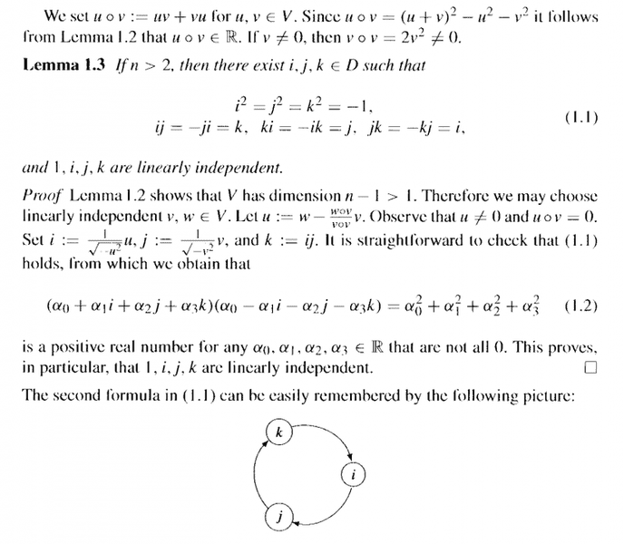

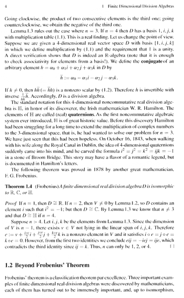

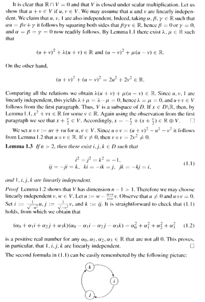

" ... ... what about ##n = 3##? ... ... "Bresar answers this question on page 4 after proving Lemmas 1.1, 1.2, and 1.3 ... (see uploads below)
Bresar writes:
" ... ... Lemma 1.3 rules out the case where ##n = 3##. ... ... "Can someone please help me to understand why/how Lemma 1.3 rules out the case where ##n = 3##?
Lemma 1.3 and its proof read as follows:

As to questions one and two, it's as so often: rigor lies in the precision of wording.
The division algebras ##D## are defined as those "containing" ##\mathbb{R}## (cp. discussion in a previous thread).
To be more precise: division algebras here are real vector spaces, i.e. ##\forall_{r\in \mathbb{R}}\; r\cdot 1_D \in D##. This means a copy of ##\mathbb{R}## is via the mapping ##r \leftrightarrows r\cdot 1_D## a one-dimensional subspace of ##D##. Since ##\dim D = 1## it is already equal.

As to question 3: In Lemma 1.3. we have already four ##\mathbb{R}-##linear independent elements ##1,i,j,k \in D## if ##n>2##. So ##n>2## implies that even ##n\geq 4## holds.
I suggest you work out the case of dimension two as an exercise. You may use Lemmata 1.1.,1.2.,1.3. and the definition of ##V##. ##\mathbb{C}## is already an example. One has to show that any other ##2-##dimensional division algebra over the reals look like it, i.e. has an element ##j## with ##j^2=-1## that can be mapped to the imaginary ##i## in ##\mathbb{C}##.

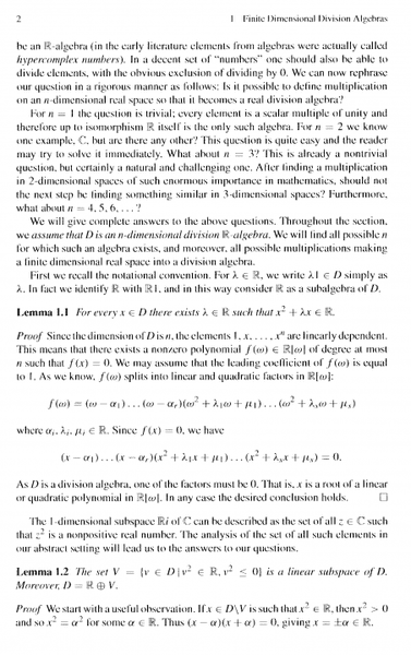

Just out of curiosity - the results of lemma 1.1 depend on factoring a polynomial in ##\mathbb{R}[\omega]##, so what happens when we study finite dimensional division algebras over ##\mathbb{Q}## instead of ##\mathbb{R}## ?
It will get a little bit messy, because every field extension of ##\mathbb{Q}## is a division algebra, ##\mathbb{Q}(\sqrt[17]{83},i)## an algebraic extension, ##\mathbb{Q}(\pi, e, 2^{\sqrt{2}})## a transcendental. Plus the same division algebras as over ##\mathbb{R}##, only with ##\mathbb{Q}##.
It hard to understand that phenomena intuitively. Why does less capability in factoring ( by ##\mathbb{Q}[\omega_1, \omega_2,...] ## vis-a-vis ##\mathbb{R}[\omega]## lead to more versatility in the possible finite dimensional division algebras ?
Here, I'm thinking of ##\mathbb{Q}[\omega]## and ##\mathbb{R}[\omega] ##as being polynomials involving the "indeterminate" ##\omega##, not as polynomials in some specific mathematical object like ##\omega = \sqrt{3}##.
I suppose it relates to the fact that there is more diversity in the types of factors that irreducible polynomials over ##\mathbb Q## can have. Over ##\mathbb R## the factor polynomials can have order only 1 or 2, whereas over ##\mathbb Q## they can have any order.
Less capability in factoring goes along with a richer variety of types of factors.
At the extreme, in ##\mathbb C## all factors are the same type: ##(x-z_k)##.
