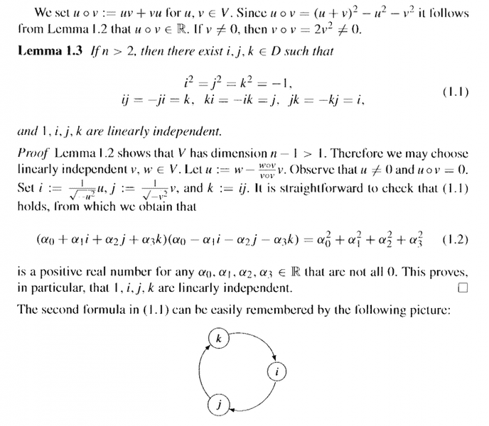

Lemma 1.3 reads as follows:
In the above text by Matej Bresar we read the following:
" ... ... Set ##i := \frac{1}{ \sqrt{ -u^2 } } u , \ \ j := \frac{1}{ \sqrt{ -v^2 } } v## , and ##k := ij##.
It is straightforward to check that (1.1) holds ... ... "
I need some help in proving that ##ij = -ji = k## ... sadly I cannot get past the point of substituting the relevant formulas ...
Hope someone can help ...Peter

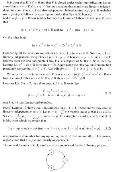

EDIT ... I must admit that as I reflect further on Lemma 1.3 I am more confused than I first thought ... why is Bresar defining another 'multiplication' in V ... that is why define ##\circ## ... we already have a multiplication from D ... and how does the new definition ##\circ## play out when validating 1.1 ...============================================================================

Math Amateur said:
I need some help in proving that ##ij=−ji=k## ... sadly I cannot get past the point of substituting the relevant formulas
That ##ij=k## is true by definition of ##k##. So all we have to prove is that ##ij=-ji##, ie that ##ij+ji=0_D##. Here goes:
\begin{align*}
ij+ji&=\left(\frac1{\sqrt{-u^2}}u\right)\left(\frac1{\sqrt{-v^2}}v\right)
+\left(\frac1{\sqrt{-v^2}}v\right)\left(\frac1{\sqrt{-u^2}}u\right)\\
&\textrm{[I've now edited the above line to remove the typo pointed out by fresh_42 below. Thank you]}\\
&=\frac{uv+vu}{\sqrt{u^2v^2}}
\end{align*}
which is zero iff the numerator is zero.
But the numerator is ##uv+vu=u\circ v=0##, as claimed in the second line of the proof.
To see that that claim is true, we calculate as in the alignment below. But first, note that ##v^2## commutes with everything, since ##v^2\in\mathbb R'## so that ##v^2=a1_D## for some ##a\in\mathbb R,\ a\leq 0##, and ##1_D## commutes with everything, as does scalar multiplication:
\begin{align*}
u\circ v&=uv+vw\\
&=\left(w-\frac{w\circ v}{v\circ v}v\right)v+v\left(w-\frac{w\circ v}{v\circ v}v\right)\\
&=wv+vw-\frac{(w\circ v)v^2+v(w\circ v)v}{v\circ v}\\
&=wv+vw-\frac{(wv+vw)v^2+v(wv+vw)v}{2v^2}\\
&=\frac{2wvv^2+2vwv^2-(wv+vw)v^2-v(wv+vw)v}{2v^2}\\
&=\frac{2wvv^2+2vwv^2-wvv^2-vwv^2-vwv^2-v^2wv}{2v^2}\\
&=\frac{2wvv^2+2vwv^2-wvv^2-vwv^2-vwv^2-wvv^2}{2v^2}\\
&=\frac{0}{2v^2}=0
\end{align*}
where we have repeatedly used the ability of ##v^2## to commute with anything else, to move it about.

Just a few remarks. Firstly, ignore the last bracket in @andrewkirk 's second line, it's a cut+paste typo. Secondly, I'll try to answer
I think we have to consider the following: Goal of all this is, to show there are division algebras over ##\mathbb{R}##, namely the complex numbers ##\mathbb{C}=\mathbb{R}+V=\mathbb{R}+i\cdot\mathbb{R}##, the quaternions ##\mathbb{H}=\mathbb{R}+V=\mathbb{R}+i\cdot\mathbb{R}+j\cdot\mathbb{R}+k\cdot\mathbb{R}## and possibly the octonions as well.
Therefore Lemma 1.2 which proves that ##V## (the imaginary part of our ##D##) is a linear subspace.
Many of the techniques here, e.g. Lemma 1.1., are simply a reduction to formulas in the real numbers, where we know how to do calculations, whereas in a potential division algebra ##D## we don't - yet. Furthermore, we have to use the specialties of the real numbers somehow, namely that it is an Archimedean ordered field, which Lemma 1.1. is closely related to, or that squares in ##\mathbb{R}## are always non-negative.
So Bresar uses the structure in ##\mathbb{R}## to deduce insights on ##D##. As he also knows, where this ends, namely at ##\mathbb{C},\mathbb{H}## and ##\mathbb{O}## and that ##i\,\cdot\,j=k=-j\,\cdot\,i## holds, it makes sense to examine the "zeroness" of ##i \circ j = i\cdot j + j\cdot i## which explains the additional (now made commutative again(!)) multiplication. In addition ##i,j,k## have to be defined somehow, only by the use of a construction with real numbers. The entire difficulty here is not to show that ##\mathbb{C},\mathbb{H},\mathbb{O}## are division algebras, but to show they are the only ones. Therefore we need necessary conditions for ##D## being a division algebra over ##\mathbb{R}##, the more the better.
At least this is what I hope for, because to show that the examples are actually division algebras, we could simply perform some calculations instead.
