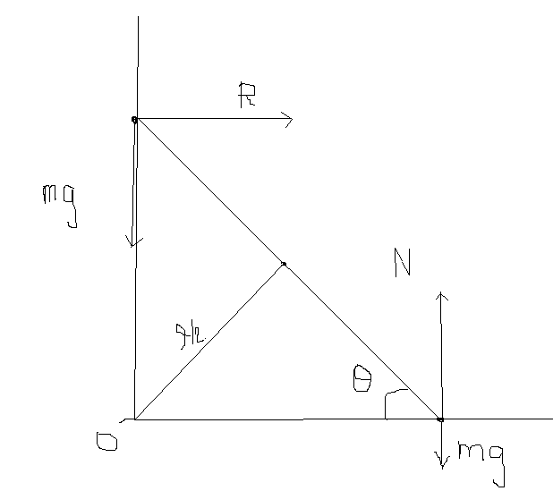

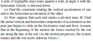

i know problems of this kind have been posted a lot but i have a few of my own questions please take a look at them thanks
i am having several conceptual errors in rotational dynamics
one of them is :
since the rod is massless must there be net zero force and torque on it?
T = I α
f= ma
a) is easy
x^2 + y^2 = l^2\\
{\dot x}^2 + x \ddot x = -{\dot y}^2 - y\ddot y
the problem comes in at b
i know the centre of mass traces out a circle of radius L/2 about the origin
i do not how to proceed
--like from many websites states N= 2mg but would that be so as the centre of mass is surely coming down then why must net vertical force be zero?
--please help i am not being lazy i truly need help
vishnu 73 said:
a) is easy
I would think the question wants an answer involving only ##\theta, \ddot x, \ddot y, l##.

Let the force in the rod be F. What equations can you write for the two accelerations?

m a_{cm,y} = N- 2mg\\
m a_ {cm,x} = R\\
energy equation no rotational terms as massless rods
mgl = mgl sin \theta + \frac{1}{2}m (\dot y)^2 + \frac{1}{2} m(\dot x )^2\\
2gl(1 - sin \theta) = (\dot y)^2+ (\dot x)^2
i am really confused about where am i going some direction may help

No. The Y mass does not directly feel N, it feels the vertical component of the force in the rod. Similarly the X mass feels the horizontal component of it.
ok now i see
is it
Fsin\theta - mg= \ddot y\\
Fcos \theta = \ddot x
vishnu 73 said:
ok now i see
is it
Right, except you forgot the m on the right in each.
i am getting
\ddot xtan \theta - g = \ddot y
initially theta is 90 but tan 90 blows up
vishnu 73 said:
i am getting
If the initial position were upright there wouldbe no horizontal force on the lower mass, so no movement.
The initial condition is with some θ=θ0, but ##\dot \theta=0##.
