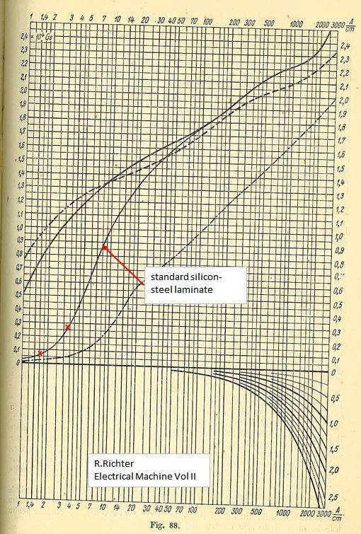

From magnetic curve B=f(H) of an usual silicon-steel laminate for transformers: H=magnetic field[magnetizing force] B=magnetic flux density[or induction]
If H=10A/cm B=0.9Wb/m^2
If H=20A/cm B=1.5 Wb/m^2
The ratio 1.5/.9[Wb/m^2]≈160/97 [H]
I'm sorry. Wrong part of the B_H curves. For small H [less than 3 A/cm] the B-H curve is parallel with abscise. Let’s say for 5mA supply current H= 1.6 A/cm and for 10mA[ 2 times]= 3.2 A/cm. According to attached curve for 1.6 A/cm B=0.075 Wb/m^2 then μ=0.075/1.6=0.046875 and for 3.2 A/cm B=0.25 Wb/m^2 μ=0.25/3.2=0.078125
L=K*μ
L10mA/L5mA=μ3.2/μ1.6A/cm=0.078125/0.046875≈160/97
244434
  • Magnetization chart from R. Richter's Electrical Machine Vol II (Fig. 88), B in 10^4 Gs against H in A/cm on log scales; several curves with red markers and a label reading standard silicon-steel laminate.

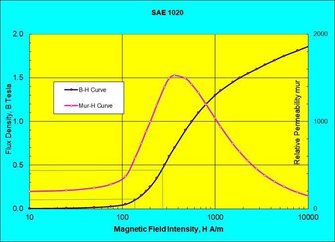

I think the above B-H curve is for low carbon steel and not for silicon-steel laminate[my mistake!].In the book these curve lines are similar.
Here attached it is another B-H curve for Low Carbon Steel as per
https://magweb.us/free-bh-curves/
  • Chart titled SAE 1020 plotting flux density B in Tesla (left axis, 0 to 2.0) and relative permeability mur (right axis, 0 to 2000) against magnetic field intensity H in A/m on a log scale from 10 to 10000. A black B-H curve rises steeply from near zero to about 1.85 T, and a magenta mur-H curve peaks near 1500 around H of 350 A/m before falling.
M = ## N_2 \phi_{21}/i_1 ## assuming zero secondary current. ## \phi_{21} ## = flux thru secondary due to primary current ## i_1 ##.
so it's essentially dB/dH since H ∝ ## i_1 ##.
B vs. H in your last diagram clearly shows dB/dH starting out low, then rising to a max., then receding again.
So as you increase current, flux will be lower at first, then rise, then drop. You seem to have operated in the lower→higher region.
