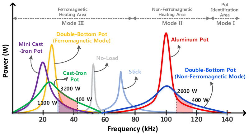

Indeed, induction stoves operate in the 25-50 kHz range for a good reason. For example, http://10.3390/en12152915 design study of a 3.2 kW induction cooking system depicts the following:
Graph of power (W) against frequency (kHz) from 0 to 140 kHz showing resonance curves for pots and loads: mini cast-iron, double-bottom ferromagnetic, cast-iron, no-load, stick, aluminum and double-bottom non-ferromagnetic, with heating zones marked.
Note that the power delivered to various pots is maximized at or above 20 kHz. In contrast, only negligible power is available below 1 kHz.
Induction cooking at 50-60 Hz is a nonstarter.
