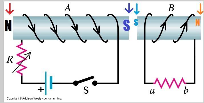

How is the back induced current in the secondary coil transferred to the primary ? I know how mutual induction occurs (and I know that a the bst possible example would be a transformer) but I don't understand how it actually occurs ( I know it,but I still can't get it) I mean I get why when current flows in primary coil ( at the instant of switching the cicuit on) there is a change in current intensity by increase and that produces changing magnetic flux which in turn affects the secondary coil and an back induced current (or e.m.f) is formed in the secondary one. Then what ? How is this "induced current" transferred to the primary coil such that it opposes the original current (in the primary) and let's current grow slowly ? I should also mention that I'm not only under advanced level , but under ordinary level too , so please I beg you try to make the answer as simple as you could ,so that I won't be lost in a labyrinth of never-ending laws , eternal thanks in advance ~
;c; please anyone ,I'm going to be examinated in this and I can't study anything without understanding it ! Please help me

Yes , its exactly what I needed , thank you so much , but uhm , the obstacle lies within the whole visualization and Lenz law , for in the pic I've attached , if the primary coil (the one connected to the battery) induces emf in the secondary coil , the direction of the induced current will be opposite to the direction of original current in the primary coil , so the (I) induced will result in a magnetic flux around the secondary coil which will affect the primary coil and induce a current in a direction opposite to that in the secondary ! But wait a second ... isn't the current in primary coil already opposite in direction to the secondary ! and my ultimate problem arises here , please help and I'd be eternally grateful to you :smile:
One or two things to get straight first of all.
• It's not currents (or flux) that are opposed, but changes in currents (or changes in flux).
• If current is flowing in the sense you've shown in your primary, then the flux in the core will be going from left to right. [You get this by a rule called the right hand screw rule (or right hand grip rule, or corkscrew rule)]. This means that if the core has ends (like yours) the right hand end will be North for the current as you've drawn it.
• The coils share a common core (which is usually a closed loop). It's misleading, I think, to have one part of the core magnetised in one direction, and the other part the other way.
• The current in a coil is given by the algebraic sum of the emfs in that coil's circuit, divided by the resistance in the circuit. The emfs may re-inforce or tend to cancel.
Now we can start work on your question. Let's call sense of current you've shown in your primary the positive sense.
If the primary current is positive and increasing (or negative but getting less negative), there will be an emf induced in the negative sense in the primary (self induction) and an emf induced in the negative sense in the secondary (mutual induction).
If the secondary has a resistor connected across it, a current will flow in the secondary in the negative sense. If this secondary current is getting more negative it will induce an emf in the positive sense in the secondary (self induction) and in the positive sense in the primary (mutual induction).
But be careful. Just because there is an emf in the negative sense induced in the secondary because the primary current is positive and increasing does't mean that the secondary emf is necessarily getting more negative; it might be getting more positive. This will depend on the way the primary current is changing with time, which will depend on the way the externally applied voltage changes with time.
If this all seems complicated - it is! Actually it gets simpler when you start to express it all mathematically.
