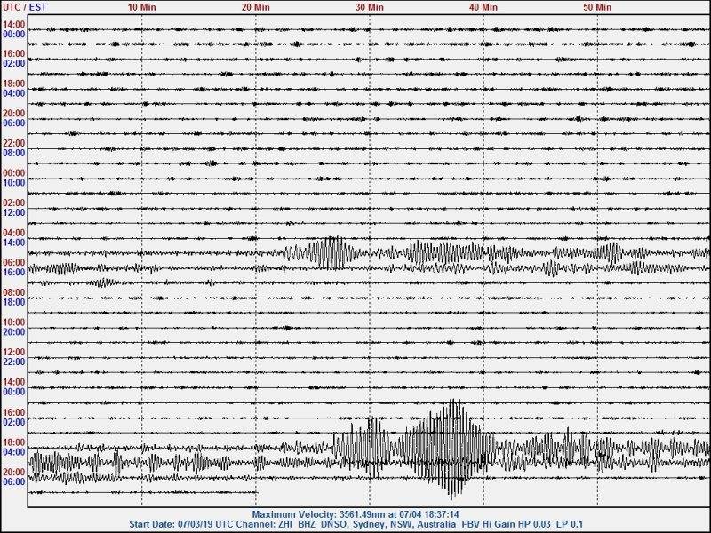

the seismogram from my recorder …..
The first event is a Mw6.2 offshore British Columbia, Canada
The lower event is the Mw6.4 from CaliforniaCheers

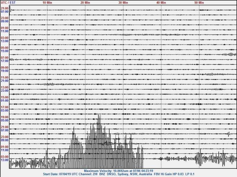

A seismogram of the Mw7.1 just before it starts overwriting itself
1 hour's worth of recording

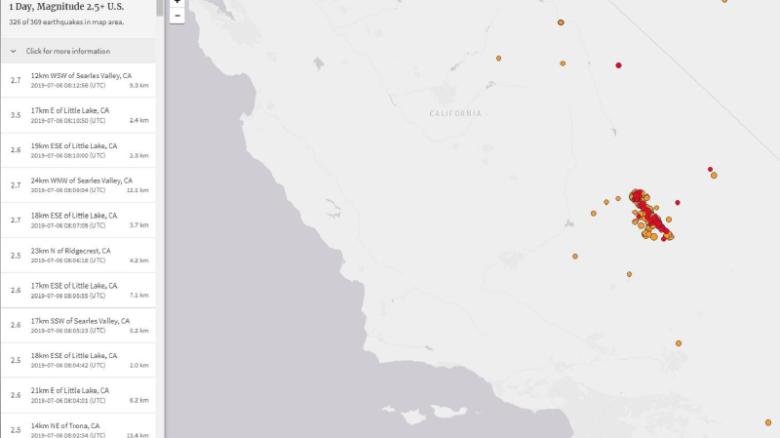

jim mcnamara said:
@davenn How does this mess show up your seismograph? The USGS map is pretty fuzzy, - due to limits of resolution?
Being on the other side of the Pacific, I only recorded the Mw's 6.4 and 7.1, so the other much smaller events
didn't have any effect :smile:

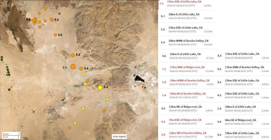

A zoomed in version of the map that @jim mcnamara posted above. I have annotated it and only included
the M4.6 and above events ...
( Sorry for the poor quality, I had to heavily compress this for PF)

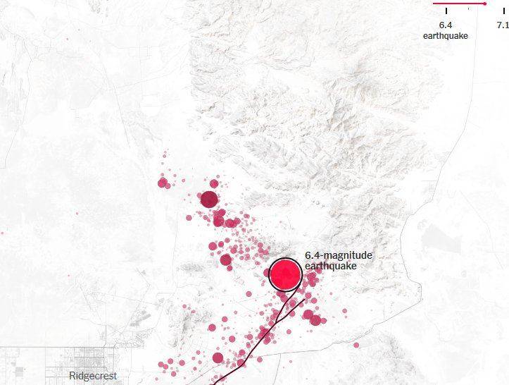

Here is a NY Times article on these two earthquakes and 1,000's of other earthquakes that followed them.
This article has some great visualizations, showing the location/size of earthquakes on a map, during and after the recent two big ones, rolling out in the order that they occurred in.
The earthquakes are shown on a map of the affected area, as well as a larger scale version for the whole state (not showing the size-to-strength relationship).
Here is a non-motion screen capture of the graphic:
Watching these earthquakes appear on the maps, makes one think of how earlier quakes locations might be triggering later ones.

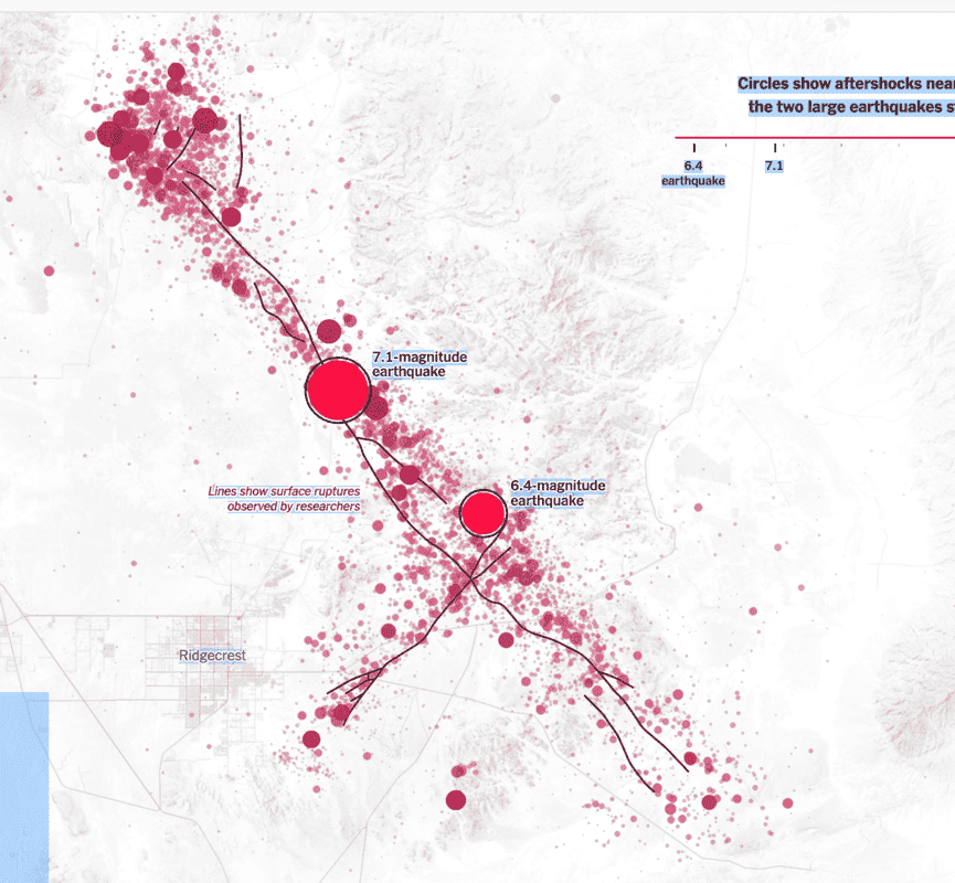

What you need to know/understand is that the rupture lengths of the 6.4 and 7.1 rupture areas are not
limited to within the area of the circles on the mapped faults.
In particular, rupture length of the M7.1 would have been from the Y junction just south of where it is
located on the map and right along to the northern end of the aftershock zone.
The aftershocks then occur along that ruptured length of fault and within the region immediately
surrounding it. You can see how there were other smaller faults that ruptured as part of the stress
field realignment.
The M6.4 ruptured the faults in the southern quarter of the zone. The M7.1 the top three quarters but
note that it extended to the SE through the M6.4 area as the full length of the main NW/SE trending
fault unzipped.
The M6.4 was primarily 2 unilateral ruptures
1) mainly on the couple of faults that run SW to NE
2) and then in an area to the NW ... this initiated the M7.1 which was a bilateral rupture
centred on where the M7.1 circle is located
Complex ruptures like this are quite common. There's been 2 major quakes in New Zealand in recent
years where many smaller faults close to the main fault ruptured.Dave
