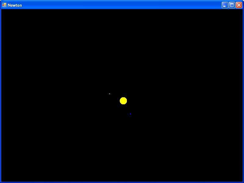

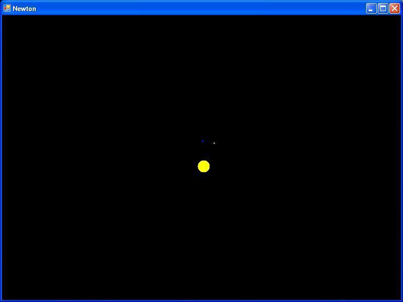

A long time ago, I wrote a program that takes bunches of particles and applies Newtonian gravity to each so they interact. Lately I've rewritten this program, in an effort to simulate planetary motion. However I've ran into a bit of a snag, I can get a Sun-Earth system to behave properly, and I can get a Earth-Moon system to behave properly, but when a Sun-Earth-Moon system is created, the Earth will orbit fine, but the moon will simply follow the Earth around, never orbiting around it, and the distance between the Earth-Moon will slowly increase. I have attached 3 images (Absolutely not to scale):
The first shows the simulation right after start, the Gray dot is the moon, slightly under it but somewhat visible is the Earth in Blue, and the Yellow orb is...well I'll let you guess ;)
The second shows the moon clearly trailing behind the earth. And the third for good measure is after the moon has reached about 1AU from the sun.
To calculate the initial velocities I use the formula v = gc * (m / d), I apply this velocity on a vector perpendicular to the main orbiting body (Sun for Earth, Earth for Moon). For the moon I'm calculating the velocity to orbit the earth, and then adding the velocity to orbit the sun to make it relative to the sun.
I find the Gravitational Acceleration using the formula a=gc * (m / d^2), I then find a normalized 2d vector to the gravitating body. I multiply this acceleration by the components of the 2d vector. and then add it to the XY position. For the moon here is the algorithm:

Whew, that's a lot to type. Anyways, as you can see in the attached images, the moon doesn't exhibit the expected motion. It seems that the way I am adding the acceleration to the moon object is in error, but I have checked and recheck my formulas, masses, distances, vectors and acceleration for errors and cannot seem to spot it. I appreciate any and all help! This has me going in circles it seems.

Looking back on some of my past notes I realized that the forces need to be added together before being multiplied into the vectors. The final moon routine looks like this:

Unless this is incorrect, this improves the behavior of the moon. It now will stay tethered to AND orbit around it, but slowly the moon still drifts away :frown:. Because of the vast improvement in behavior, I think it may be how I'm starting the simulation.
I start with the sun in the middle, the Earth is directly to the left of it with its vector pointed downward and perpendicular to the sun. The moon is to the left of this, with its vector pointed downward and perpendicular to the earth. I then calculate the initial velocities, multiplied by the vector, to set the planets up. So the Earth goes counter-clockwise around the sun, and the moon counter-clockwise around the earth.
The moon is the only object receiving gravity from 2 objects, the Earth is only effected by the sun, and the sun doesn't move at all. And like I said, I checked my starting velocities, masses, gravitational constant, vectors, the works, so it has to be in how I'm handling the acceleration or how I'm positioning everything initially.
Do you get the same result if you make the time step say 10X or 100X smaller? If you don't, then the inaccuracy is in the numerical accuracy of the simulation. If you do, then maybe the equations you used are incorrect. (There's also the possibility that the system is genuinely unstable, but I'd think about that later. BTW, your attachments haven't been approved, so I haven't seen them.)
I do get the same results actually. The system should be stable, according to all other simulations I've seen, since I'm using real world values for these things. I wish I had the original source to peek at, all I have is my notes.
I'm pretty sure the equations are correct, I've used them before and they're in my handy notebook of things like that. Whatever is happening is within how I am applying the forces to the moons direction vector, I think. The difference between the moon and the Earth is there are 2 direction vectors, if I remove the sun, and keep the moon relative to the earth, it will orbit fine, however that's not what I want since I love the beauty of dynamic systems. So I'm sure the force is just being applied in the wrong direction, Since I've noticed the orbit of the moon becomes very eccentric (now that its orbiting at all)

This isn't valid. Look at it in terms of units. X and Y are positions: they have units of length. Acceleration is length/time squared. You can't add position and acceleration any more than you can add any other pair of dissimilar quantities such as distance and mass. What is 1 meter plus 1 kilogram?
What you need to do is use the velocities. Acceleration changes the velocity as time changes, and velocity changes the position as time changes. Some nomenclature first:

Here is a very simple state propagator: First calculate the accelerations of the Moon, the Earth, and the Sun toward each other. The Moon's acceleration toward the Earth and Moon is
<br /> \boldsymbol{a}_m(t) &amp;=<br /> \frac{GM_s}{r_{m,s}^2(t)}\hat{\boldsymbol{r}}_{m,s} +<br /> \frac{GM_e}{r_{m,e}^2(t)}\hat{\boldsymbol{r}}_{m,e}<br />
The accelerations of the Earth and Sun are similar. Now update the states to your next simulation time step:
<br /> \aligned<br /> \boldsymbol{x}_m(t+\Delta t) &amp;=<br /> \boldsymbol{x}_m(t) + \Delta t\,\boldsymbol{v}_m(t) \\<br /> \boldsymbol{v}_m(t+\Delta t) &amp;=<br /> \boldsymbol{v}_m(t) + \Delta t\,\boldsymbol{a}_m(t)<br /> \endaligned<br />
The approach outlined above is too simple. It is called Euler integration and is not numerical stable. Just as simple, but a lot more stable, is to calculate the new velocities first:
<br /> \aligned<br /> \boldsymbol{v}_m(t+\Delta t) &amp;=<br /> \boldsymbol{v}_m(t) + \Delta t\,\boldsymbol{a}_m(t) \\<br /> \boldsymbol{x}_m(t+\Delta t) &amp;=<br /> \boldsymbol{x}_m(t) + \Delta t\,\boldsymbol{v}_m(t+\Delta t)<br /> \endaligned<br />
This simple change will make your simulation a lot more accurate. It is called Euler-Cromer integration by some, symplectic Euler integration by others. Welcome to the world of numerical integration! Euler and symplectic Euler are just the tip of the iceberg. There are much better schemes that are also more complex, some considerably more complex.
