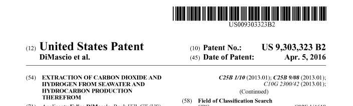

Looks like Navy might have a head start. They can make jet fuel out of the CO2in seawater.
I'm not enough of a chemist to assess difference between hydrocarbons and carbohydrates though.
