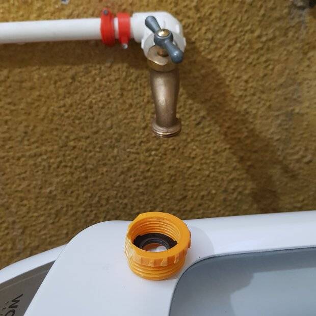

Is there any tool that can grip the yellow threads and turn it? I use pliers but they are very small. I even used vise grips but the teeth are very small. There is a rubber gasket inside the yellow plastic adaptor which has female thread on top (the male thread at bottom is for 1/2" conversion). The faucet is 3/4" and has male thread. I tightened the 3/4" plastic adaptor with my hands but can't remove it. For this situation. Mechanically, Is it because the faucet thread and adaptor threads are not compatible or more about the gasket causing it to tighten?
Or if the description above is vague. Just please tell me what kind of tool that can engage the threads. Pliers and vise grip have small close teeth.
The teeth of wrench are very closedly space. Is there other tool that can do it?
I just used saw to cut the adaptor and destroy it just to remove it.

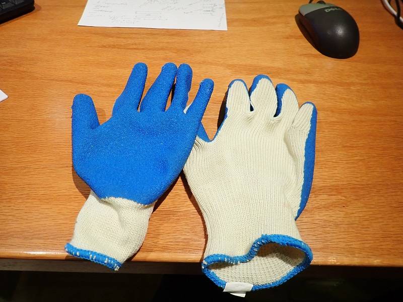

My preferred solution, at least for a first attempt, is a pair of grippy gloves. I keep a pair in the kitchen, and a second pair in my shop. They both get plenty of use. They do two things - shield my delicate fingers from sharp edges so I can grip harder, and increase friction so I can get more torque from the same clamping gripping force.
I also have a pipe wrench for the really stubborn cases.

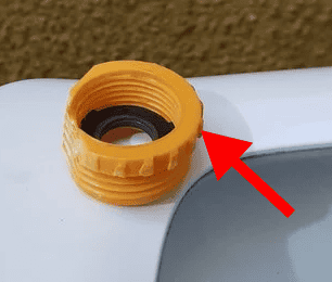

I meant I didn't want to leave some small scars on the outer part of the plastic assembly. How do you call those outer part? In wheels in cars/vehicles, the outer part of tire is called threads so I mention threads. What is the right term then?
Why did you give picture of 18" pipe wrench? Does the 18" mean it is the opening of the wrench? If i'd buy one, maybe a 2" is enough? The heavier one may be so heavy it may pull the entire faucet off the PPR piping when turning it.
Why not? You were willing to destroy one of them.
The wrench is meant to be applied to this part, not the threads.

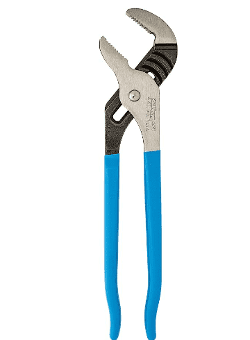

I think a pipe wrench is overkill.
I use channel locks:
I borrowed a pipe wrench as well as ordered both the channel lock and a pipe wrench.

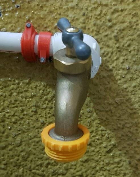

However, even if I used a pipe wrench, the tap adaptor still leaked! Then I realized why, it's because the NPT in the faucet is not compatible with the GHT of the tap adaptor. See:
https://homeandgardentalk.com/ght-vs-npt-compatability/

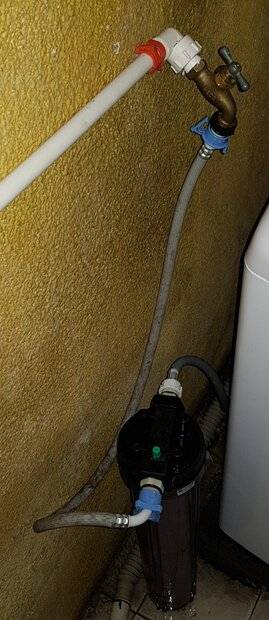

I used the faucet to the sediment filter connected to the clothes washing machine.
Has anyone used this kind of setup? First, some terms we should agree with first.
1. Do you also call it as faucet tap adaptor (the yellow one I sawed earlier)? It's GHT which is not compatible with the faucet NPT so either I'll get a converter or replace the faucet (which is connected to the PPR female NPT thread).
2. Do you also call the hose connector as Water Hose connector quick release? What else do you call it? Or haven't you seen anything like it?
3. The sediment filter is GHT. I connected the washing machine water hose directly to the sediment filter via a 3/4" male to male adaptor.
4. Ok. What other ways to do it? How did you set up yours? The washing machine could another output like a plain kitchen sink faucet, etc.
