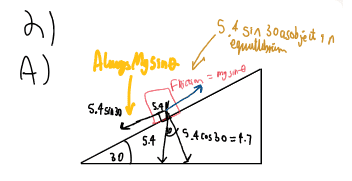

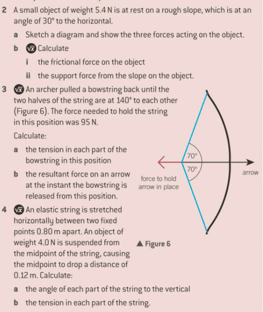

I know HOW to get the answer as i underwent trial and error, but I don't actually understand the process of why we do what we do:
Friction = mgsin θ
These are the questions I am failing to comprehend despite their very basic nature
This is the wonderful support from the book explaining how to get the answer ! (It just gives you the answer no working out which is annoying)

I would like to start with 2 B II, the support force from the slope on the object
Sorry i looked at the wrong question, I meant Question 4 sorry for any inconvenience I caused you
No need to apologize: we help voluntarily :smile:
In the mean time I have looked at the first one (2a) and I do have comments on that one:
You are asked to show the three forces on the object. I see four arrows; two are correct and one is missing
Agree ?
You are also asked for the support force from the slope acting on the object. Any suggestions ?

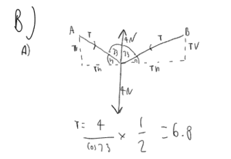

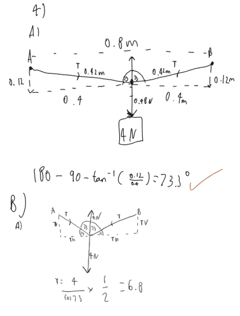

Re Question 4 (PF prefers one item per thread to facilitate referencing and avoid confusion, but never mind...)
What you appear to do looks OK to me, but you are just like the book: you don't tell. What's the very basic nature under this one ?
Equilibrium ##\Leftrightarrow## sum of forces is zero
A better drawing is in order: in your picture the tensions don't act on the object
And somehow I get 6.96, i.e. 7.0 N, not 6.8
(golden rule: don't round off intermediate results).

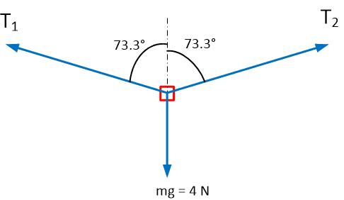

The picture I had in mind:
General idea clear now ? Basic nature :wink: ?

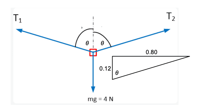

Platinum rule: Don't find intermediate angles if you are looking for trig functions.
Here, $$\sin\theta=\frac{0.80}{\sqrt{0.12^2+0.80^2}}~;~~\cos\theta=\frac{0.12}{\sqrt{0.12^2+0.80^2}}~;~~\tan\theta=\frac{0.80}{0.12}.$$ :wink:
  • Haha
Ancient dutch expression: there's always boss above boss
Ancient greek expression: turtles all the way down
  • Haha
WOW! I can't thank you enough, especially for question 4 as I realise that whilst I was sort of there I made it so much weirder than it had to be, Many thanks to you guys
