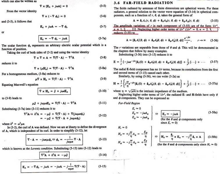

See attached scanned pages of page 118(left side) and page 125(right side) of Antenna Theory by Balanis.
On the left side, it is just some basic EM where
[tex]\nabla\times \vec E=-\frac{\partial \vec B}{\partial t}\;\Rightarrow\;\vec E=-\nabla V-\frac{\partial \vec A}{\partial t}[/tex]
Then to Lorentz thingy ##\nabla\cdot \vec A=-\mu\epsilon \frac{\partial V}{\partial t}##.
And so on...
The only thing different is it is in time harmonic form where ##\frac{\partial}{\partial t}\rightarrow\;j\omega##.
Now going to the right side. I underlined the sentence that I have no idea where that comes from! What is ##\frac {1}{r^n}=0## where n=,2,3,4...
Please explain what is that. This supposed to be very basic thing that
[tex]\vec B=\nabla\times\vec A[/tex]
Then for far field where it is assumed plane wave,##\vec E=\eta\hat R \times \vec H##
This is a very basic knowledge of finding E and H from A. Where is all the what looks like numerical stuff come from?
Please help.

If you look at (3-58a) [itex]\tilde {E}=-j\omega \vec{A}[/itex]
This is nothing more than
[tex]\nabla\times \vec{E}=-\frac{\partial{\vec{B}}}{\partial{t}}=-\nabla \times \frac{\partial{\vec{A}}}{\partial{t}}\;\Rightarrow\;\nabla\times \vec{E}+\nabla \times \frac{\partial{\vec{A}}}{\partial{t}}=0\;\Rightarrow\;\nabla\times\left[\vec{E}+\frac{\partial{\vec{A}}}{\partial{t}}\right]=0[/tex]
[tex]\Rightarrow\;\vec{E}=-\frac{\partial{\vec{A}}}{\partial{t}}=-j\omega\vec{A}[/tex]
Why all the fuzz?

For harmonic time dependence, i.e.,
[tex]\vec{E}(t,\vec{r})=\exp(\mathrm{j} \omega t) \vec{E}'(\vec{r}),[/tex]
and for all other fields too, you have
[tex]\vec{E}=-\vec{\nabla} \vec{\Phi}-\partial_t \vec{A}[/tex]
gives
[tex]\vec{E}'=-\vec{\nabla} \Phi'-\mathrm{j} \omega \vec{A}'[/tex]
etc.
For the Lorenz (it's the Danish physicist Ludvig Lorenz who was the first to simplify Maxwell's equations by the gauge condition) gauge you have (for [itex]\mu=\epsilon=1[/itex])
[tex]\Box \Phi=\rho, \quad \Box \vec{A}=\vec{j}[/tex]
which translates into
[tex](-\Delta - k^2) \Phi'=\rho', \quad (-\Delta-k^2) \vec{A}'=\vec{j}'[/tex]
with [itex]k=\omega/c[/itex].
The wave equation thus translates to the Helmholtz equation for harmonic time dependence.

I reviewed multipole expansion and come back, here. I see what I did wrong.
[tex]\vec{E}=-\nabla \Phi-\frac{\partial{\vec{A}}}{\partial{t}}=-\nabla \Phi-j\omega\vec{A}[/tex]
How do I get to
[tex]\vec{E}=-j\omega\vec{A}[/tex]
I don't know, how you got there. Perhaps, you've constraint the Lorenz gauge condition further to radiation gauge, which you can do in the source-free region. The radiation gauge conditions are
[tex]\Phi=0, \quad \vec{\nabla} \cdot \vec{A}=0.[/tex]

what you have written is valid only in the radiation zone i.e. far field zone.In this zone only 1/r contribution survives,all other higher powers are neglected.If you will compare 3.57 to 3.56,you will immediately see the result.
Yes, this is exclusively in the far field zone only. Problem is I don't know how to derive 3.55-3.57
Can anyone show me how to derive 3-56 and 3-57 from 3-55? That would really help.
Thanks
To get 3.56,you have to solve helmholtz eqn i.e. the eqn which is satisfield by A.You also have to use an expansion of 1/|x-x'| to get all those 1/rn terms and then you will have to just put it into 3.15 to get E.Let me see if I can find a proper reference(I remember Jackson has treated something similar in the chapter on waveguides).
EDIT-Somewhat useful here

[tex]\vec{\nabla} \times (\partial_t \vec{A}+\vec{E})=0.[/tex]
This implies that the field in the bracket has a scalar potential (at least locally)
[tex]\vec{E}=-\vec{\nabla} \Phi-\partial_t \vec{A}. \qquad (3).[/tex]
For a given em. field [itex](\vec{E},\vec{B})[/itex] the potentials are not uniquely defined, but you can always use
[tex]\vec{A}'=\vec{A}-\vec{\nabla} \chi, \quad \Phi'=\Phi+\partial_t \Phi[/tex]
with an arbitrary scalar field [itex]\chi[/itex] (gauge invariance of Maxwell's theory).
As we'll see in a moment, it's very convenient to (partially) "fix the gauge" by demanding the Lorenz gauge condition,
[tex]\partial_t \Phi+\vec{\nabla} \cdot \vec{A}=0. \quad (4)[/tex]
Now you can consider the "inhomogeneous" Maxwell equations.
[tex]-\partial_t \vec{E}+\vec{\nabla} \times \vec{B}=\vec{j}, \quad \vec{\nabla} \cdot \vec{E}=\rho.[/tex]
Using (2-4) you find
[tex]\partial_t^2 \vec{A}-\Delta \vec{A}=\vec{j}, \quad \partial_t^2 \Phi-\Delta \Phi=\rho. \qquad (5)[/tex]
For harmonic time dependence, i.e., writing all fields in the form
[tex]F(t,\vec{x})=\exp(\mathrm{j} \omega t) F'(\vec{x}),[/tex]
you find from (2) and (3)
[tex]\vec{E}'=-\mathrm{j} \omega \vec{A}'-\vec{\nabla} \Phi', \quad \vec{B}'=\vec{\nabla} \times \vec{A}',[/tex]
and from (5)
[tex]-(\omega^2+\Delta) \vec{A}'=\vec{j}', \quad -(\omega^2+\Delta) \Phi'=\rho'.[/tex]
This is the starting point to solve the problem of the radiation from a given charge-current distribution for harmonic time dependence. From this you get more general cases, using the technique of Fourier transform.
Is this one
supposed to be:
[tex]-(\omega^2+\nabla) \vec{A}'=\vec{j}', \quad -(\omega^2+\nabla) \Phi'=\rho'.[/tex]
I gone through this derivation. How does this bring me any close to my original question? I need to derive (3-56) and (3-57) from (3-55) in my original attachment, and ultimately (3-58). I don't see any relation to my question.

So if
[tex]V(\vec r)=\frac 1 {4\pi\epsilon r}\int\rho(\vec r')dr'[/tex]
then
[tex]\nabla V(\vec r)\propto \;\frac 1 {r^2}[/tex]
So for far field, ##r\rightarrow\;\infty##, ##\nabla V## term disappeared and
[tex]\vec E=-j\omega \tilde A[/tex]
Just that simple?! So I don't have to go through Jackson and review Green's Function?
Thanks
yungman said:
So if
then
Thanks
I want to double verify this as I can move on using this assumption that in far field, ##\;\nabla V\rightarrow0\;\Rightarrow\;\vec E=-j\omega \vec A##.
Anyone?
In far zone the electric field is transverse in character(no radial component).
you should have read it.A(vector potential) contains radial component but does not give a radial component of electric field.Why it does not give,you can figure out it by evaluating it.It cancels.So you should review it.
