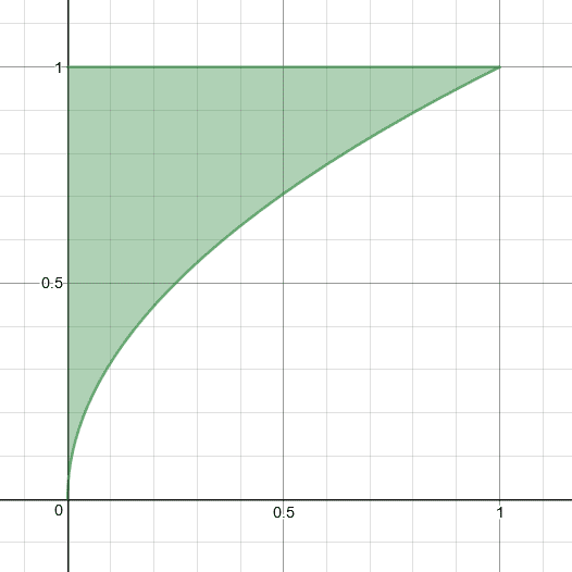

Now that Klaas has figured out what #2 is actually supposed to be, let's look first at the region over which we are to integrate:
Reversing the order of integration, we may write:
$$I=\int_0^1\int_0^{y^2} e^{y^3}\,dx\,dy$$
Can you proceed?
