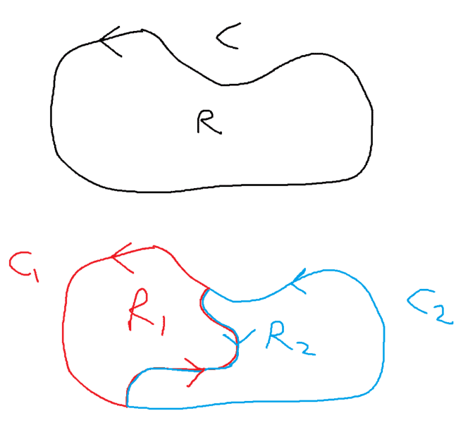

What is C1 and C2 and how are those related to C?
Is f a general vector function?

Eh no, C1 and C2 must be related to C in some way and C must be a general closed curve. It should be written in your book. Btw are you sure they should be closed? ∮ indicates so, but are you really sure the question is formulated in that way? Otherwise, if they are closed, they should be related like this (but I do not know for sure since you are not providing enough info)

So it is not a general theorem or such? Just for this example? Then you just calculate:
∮C1f⋅dr1 which is equal to 2π
and
∮C2f⋅dr2 which is equal to -2π
I mean, don’t lose track of the underlying purpose of that example: To demonstrate an application of Green’s theorem to a region with holes in it where the boundary is not a single closed curve but a union of several closed curves. In those cases Green’s theorem relates the sum of the line integrals over those closed curves to a surface integral over the contained region.
I do disagree somewhat with figure 4.3.4. There is no need to cut the region into several regions. It is enough to introduce enough cuts to make a single bounded region without holes. I used this myself last year when installing guiding cable for a lawnmower robot in my garden.

No. Yes.
The concept of being multiply connected is a topological concept that effectively tells you that a region has holes in it. It is in contrast to simply connected region.
