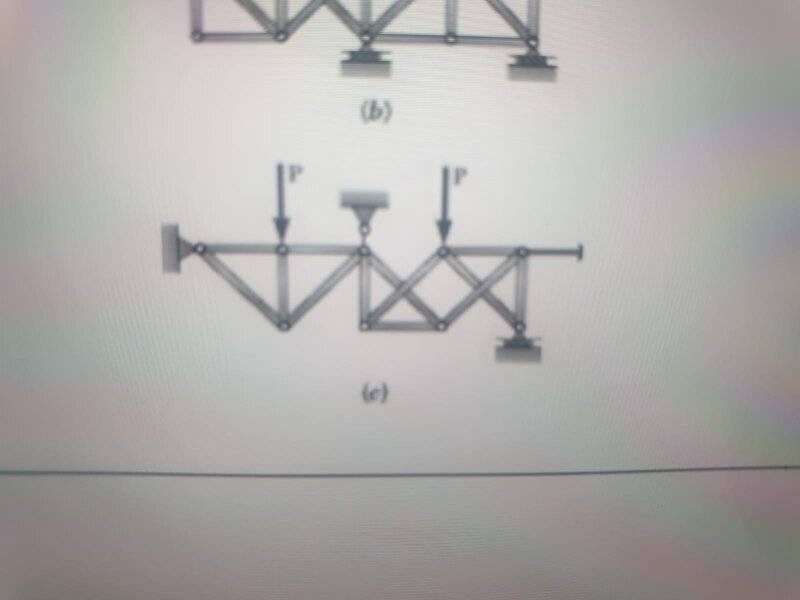

hello, i struggle with this kind of questions and i don't understand the way of thinking and how to solve this.

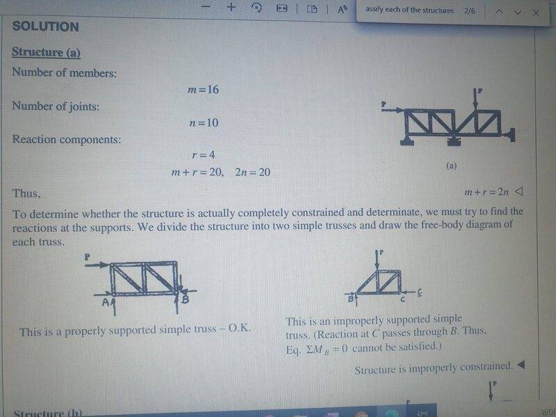

in the first picture i don't understand why Moments about point Aare a*F1 because there is the 2 P forces that do moments.?

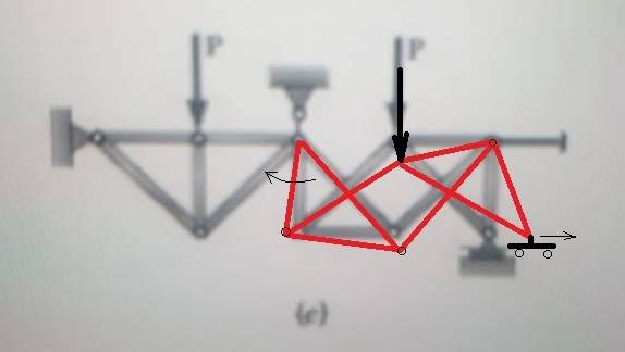

in the second problem i can't understand why there are 3 forces at B in the left side picture and 2 at the right ?

and the third picture how can i know if this structure is properly constrained or not?

For case 1: Any force, which extended line does not pass by pivot A will cause a moment about that point.
Based on that, force F1 will induce a moment, but F2 will not.
For case 2:
Left half of the armature: The vertical arrow pointing down and the horizontal arrow pointing left on B are just the reflection of the forces acting on pivot B shown on the right half of the armature.
Therefore, you should consider those forces as external loads, rather than reaction forces at sliding support B (which is unable to oppose any horizontal load).
Sliding support B is only transferring the horizontal force (represented by equal magnitude and opposite directions) between horizontal force P and horizontal support C.
B is inducing a unique vertical reaction, which is represented in both halves.
For case 3: Learning how to determine that is the whole point of that book chapter.
Without doing the calculations, I can see that the left side is properly constrained, but the right side is not, as some of its members have freedom to rotate under the load of vertical force P.
It needs, either a vertical member under P or a horizontal restriction where the slider is now located at.
The book's explanation looks inaccurate. The total moment about A is ##aF_1 + aP + 2aP##. This is clockwise, with no counterclockwise moment to balance it, i.e. it is non-zero. But the conclusion that there is no equilibrium is still correct.
But if f1 is compression instead of tension it will be clockwise and counter the p forces moment? why to assume it’s only directions is tension ?
Yossi33 said:
But if f1 is compression instead of tension it will be clockwise and counter the p forces moment? why to assume it’s only directionsI is tension ?
Are you replying to my Post #5? If so, note that ##F_1## is an external force and its direction is given in the diagram.
It acts right and its line of action is above point A. So it must produce a clockwise moment about A.
