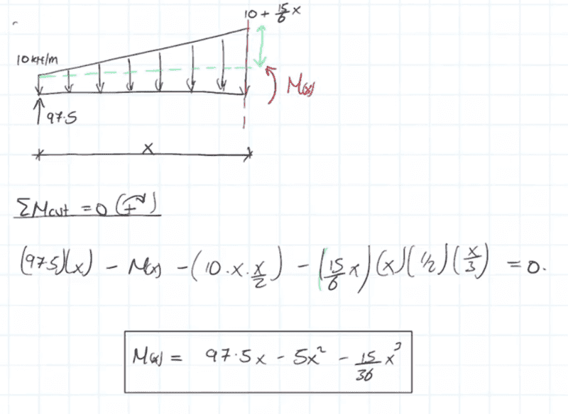

Why do I have to take the moment at the cut to get the right answer?

Svelte1
Need to set the derivative of m(x) to 0.
taking moments..
Every time I have taken moments before I have been able to solve for the required unknown regardless of what point I choose, unless there is more than 1 unknown! However I tried taking moments from the far left point load of 97.5 this time and I get the wrong answer. I don't understand why? Thankyou! This image details the correct answer taking the moment from the hypothetical cut so as to find the internal moment values.
If you take the moment around any other point than x then also the force at the cut will influence the result because it will get a non-zero lever. You likely neglected this but it is impossible to know unless you show your work.
