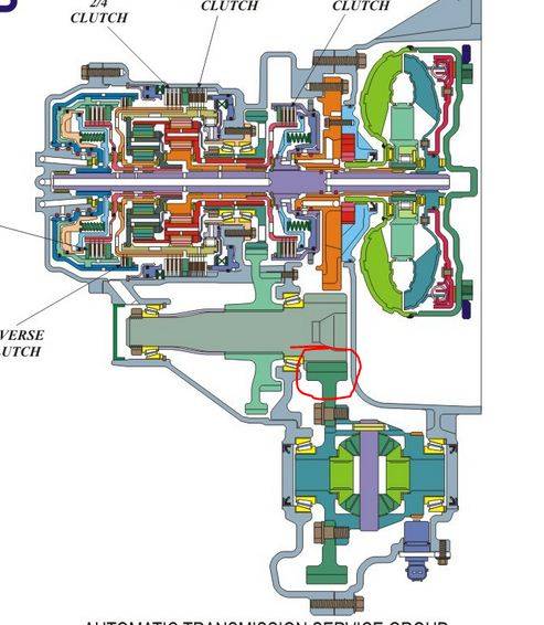

Hi,
For a final drive of a light commercial truck, I have to design a final drive helical gear pair. The expected ratio is 8.2. The centre distance is 134 mm. The input max. torque is 120 Nm. I have sized few combinations.
I have a feeling that this ratio is too deep. Pl. share me your opinions and views on this. I mainly need few check-points while designing such a deep ratio helical gear pair. Thanks.

Thank you Baluncore. This is for a final drive inside transaxle with input and output on one plane. Hence it is a helical gear pair.
My fear is if the targeted ratio 8.2 is too high to achieve... If we assume 49 teeth for bull gear and 8 for pinion teeth, do I have to anticipate any specific problems? Thanks again!
You will have a problem. A basic helical gear is designed using the same fundamental rules as those of a spur gear. The number of teeth on the pinion will be a minimum determined by tooth profile, maybe about 13, which will require the bull gear to have 106 or 107 teeth.
The advantage of the 90° hypoid is the very low number of teeth needed on the pinion while still avoiding tooth interference. I would expect a light truck to have a final drive ratio of about 4.7, maybe slightly lower with a torque converter. You should check your calculation of the 8.2 ratio. You should also check the size and possibility of reducing the road wheel diameter.
If you examine examples of the ratios used by the gear manufacturer in a manual gearbox, you will find the larger gear (on the mainshaft) is driven by the first gear pinion (part of the layshaft/countershaft). The tooth count on the first gear pinion will be very close to what is achievable on your final drive.
Hi Balluncore,
Sorry if I am beating about the bush... What if I use 16t in pinion and 131t in bull gear? Since I have a good centre distance of 134mm, I can have a transverse module of 1.8mm (approx.). If my calculation shows there is no undercut, what do you feel about this combination.
Thanks for your helps in many of my posts. :)
I feel the individual teeth will be too small to handle the expected torque. The gear will have to be very wide.
You need to examine a manual gearbox 1'st gear pinion from a vehicle with similar performance.
