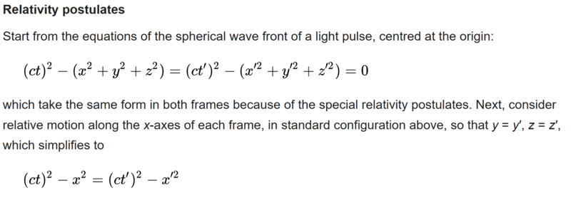

Need to resort to spherical wavefront to derive the LTs?
The discussion revolves around the derivation of the Lorentz Transformations (LTs) and the role of spherical wavefronts in this context. Participants explore whether it is valid to derive the LTs starting from a situation that considers only one spatial dimension (the X axis) instead of beginning with a full 4-dimensional spacetime perspective.
  • Some participants argue that starting with a spherical wavefront leads to a valid derivation of the LTs, while others contend that spacetime must be treated as 4-dimensional for a proper derivation.
  • One participant suggests that the terms involving the Y and Z dimensions can be neglected because they cancel out, indicating that the derivation can focus on the X dimension without loss of generality.
  • Another participant emphasizes that squaring the intervals is necessary because light travels in both directions, and that simply using linear relationships (like \(c\Delta t - \Delta x = 0\)) is insufficient to describe light propagation accurately.
  • There is a discussion about the implications of using odd versus even powers in the equations, with some participants questioning the validity of higher powers without including additional spatial dimensions.
  • One participant points out that the squared form of the spacetime interval is invariant under transformations, which is not the case for linear forms that do not account for directionality.
Participants do not reach consensus on whether it is valid to derive the LTs using only one spatial dimension. There are competing views on the necessity of considering the full 4-dimensional spacetime framework versus a simplified approach focusing on the X axis.
Participants express uncertainty about the implications of squaring intervals and the relevance of higher powers in the derivation. The discussion highlights the dependence on definitions and the need for clarity regarding the dimensionality of spacetime in the context of the Lorentz Transformations.

PeterDonis said:
If one wants to derive the interval formula, as the OP says he does, of course one cannot assume it.
Agreed. One also cannot derive the interval formula from the invariance of c alone.

PeterDonis said:
You interpreted incorrectly. The fact that the equation for a light ray happens to look like the interval equation does not mean that a derivation using the former must be a derivation of the latter. It isn't. The Wikipedia article says quite clearly that it is about derivations of the Lorentz transform (by which it really means the Lorentz boost), not derivations of the interval. And, as I have already said, none of its derivations are derivations of the interval.
Again, do you have a reference for a derivation of the interval? Because if not, this thread should be closed as we have no valid basis for any discussion of what you now say you want to talk about.
Well, if I interpreted it incorrectly, of which I am not sure, I say in my discharge that it was no big blunder, because I would have been misguided by the wording of the Wiki text, when they take a formula that exactly -as you euphemistically point out- "looks like the interval" (I would say that it "is" the interval) and then they say that it is "invariant" (literally, it "takes the same form in both frames") and finally they mention a derivation, albeit rudimentary, when they state that this is "because of relativity postulates" (that was precisely my complaint, lack of sufficient motivation)!

  • #98
Saw said:
Take Spacetime physics, Wheeler and Taylor, section 3.7, "Invariance of the interval proven", where they use as reference a timelike interval, when a light is flashed transversely with regard to the relative motion between the two frames, in the line of the light clock thought experiment. But I am fine with their approach.
Ok, good. Then, once we have the invariant interval, as has already been stated, we can derive the Lorentz boost simply by finding the group of transformations that leaves this interval invariant, which will mean leaving the spacetime geometry invariant. In other words, we are looking for a group of isometries of the spacetime. This would be a derivation of the Lorentz boost that did not rely on any properties of spherical wave fronts of light.
Are you implying that Wiki’s commented derivation is faulty because it does rely on the the properties of a spherical wavefront of light?
  • #100
Not for that reason alone, no. We eventually agreed in this thread, I think, that the derivation your referenced in the OP was faulty, but not for that reason.
