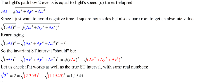

Many comments since my last one, I will reply to them collectively:
- The derivation I pointed to takes as introduction at least the first part of the other one called "Spherical wavefront", so any criticism on the former applies to the latter.
- But please note that my criticism exclusively refers to the part *up to* the formulation of the ST interval. *After that* the derivation introduces linearity and, following consequences of linearity, it hints that the form of the equations suggests hyperbolic rotation, but these are new assumptions that were not deemed necessary for deriving the ST interval.
- I have by now abandoned the argument about the teachings to be drawn from a 1+1D derivation, as the same point can be made relying on the 1 +3D one.
- My criticism (as noted, circumscribed to the part until derivation of ST interval) is only this:
* based on invariance of c postulate, you get [tex]c\Delta t = \sqrt {\Delta {x^2} + \Delta {y^2} + \Delta {x^2}}[/tex]
* based on relativity postulate, you can presume that the same interval that is valid for O will be valid for O'
* but, in order to jump from the former expression to [tex]{(c\Delta t)^2} = \Delta {x^2} + \Delta {y^2} + \Delta {z^2}[/tex] and hence to the ST interval [tex]{(c\Delta t)^2} - (\Delta {x^2} + \Delta {y^2} + \Delta {z^2}) = 0[/tex] you cannot rely on the algebraic trick "squaring both sides" because that is valid only for solving equations and finding unknowns, not for guessing which form take the dimensions in an invariant interval, which in turn depends on the nature of the change of perspective that applies in the case at hand.
- Although I initially intended to restrict the thread to what the derivation misses, I have already revealed what I had in mind as to what it misses: it should admit that the fact that the difference of perspective between frames in spacetime consists of a hyperbolic rotation is a "prius" to the ST interval. In other words, the third assumption of the derivation should come first, as a sort of third postulate.
- Ok, the null vector itself would not rotate because it is the eigenvector of the rotation matrix, but the ST interval is one that assumes that the values of ct and x, y, z transform as appropriate for a change of perspective corresponding to a hyperbolic rotation.
- Now if you said that any of the last two statements is wrong, I would be disconcerted and need your guidance as to why.
PS: BTW, I noted once that the eigenvalues are the Doppler factor (so the null vector would dilate by such factor when the transformation matrix is applied to it?); but if you explain to me how and why, that'd be great.
  • #59
This is incorrect. ##\Delta t## can be negative, but this expression cannot have a negative ##\Delta t##. The correct form for the invariance of c postulate is ##c^2\Delta t^2=\Delta x^2+\Delta y^2+\Delta z^2## from the beginning.

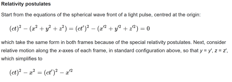

On the contrary. When you go from the correct starting expression to yours you need to include both the positive and the negative square roots.
This is a perfectly valid algebraic operation and your restriction doesn’t make sense. If an equation is true then it remains true under correct algebraic manipulations regardless of why you are doing them. That is indeed the point of algebra.
