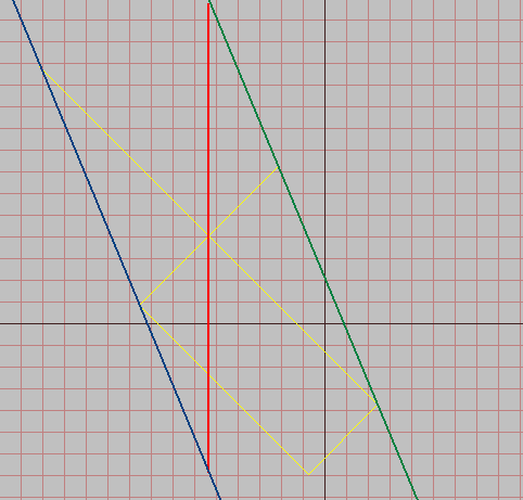

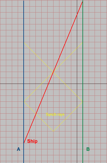

This is a space-time diagram of your scenario as I understand it. The first is from A and B's rest frame, the second is from the ship frame. I think you can read off the time between flashes on the diagram. The ship is traveling at 0.42c in the A,B frame.

I don't know if space-like intervals are invariant ( they are, see below) so ignore my advice.
The flashes are at the same time in the A,B frame (tA-tB=0) but clearly not when the diagram is boosted by -0.412c. We're talking about a change in simultaneity here, and I'm not sure how proper length comes into it. I'll try and work it out later.
[later]
Spacelike intervals are invariant, so it seems there's not much point in using one to explain a change in simultaneity. In my diagrams, the interval is sqrt(-100) in both frames. The quantity you want is one side of the triangle that defines the interval.
