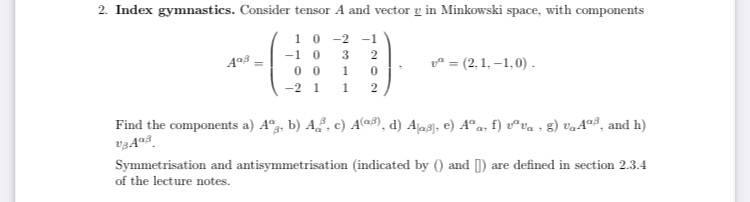

no equations, but I am most interested in c), d), g) and e). I would like to know if my attempts are correct. If not, what am I doing wrong?
We are using minkowski metric.
Matrix A with upper indices alpha beta, rows 1 0 -2 -1; -1 0 3 2; 0 0 1 0; -2 1 1 2, and vector v with components (2, 1, -1, 0), followed by a list of index gymnastics tasks a) to h) on A and v.
