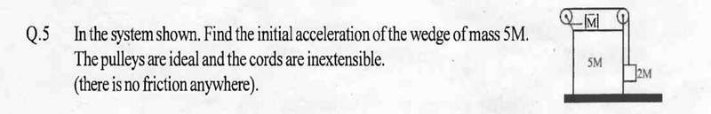

(see attachment)
I assumed that the acceleration of 5M is towards the right and is ##a##. Moving to the frame of 5M, the other two blocks experience a pseudo force.
The forces acting on M are the tension in the string, pseudo force, its weight and the normal reaction from 5M.
##T+Ma=Ma'##
Similarly for 2M,
##2Mg-T=2Ma'##
But I still need one more equation to reach the answer.
Any help is appreciated. Thanks!
The equation for the CM?

Does the CM accelerate in horizontal direction in the inertial frame of reference?

If you're not comfortable thinking about the horizontal accn of CM, you can get two more equations by introducing one more unknown, the normal reaction between 5M and 2M.
You need the acceleration of the big block with respect to the ground. Of course, the acceleration is zero with respect to itself, so you can not avoid using the inertial frame of reference.

For M, the forces acting on it are tension, weight & normal reaction from 5M.
##T=Ma## (I feel this is not correct)
For 2M, it performs two motions, one in horizontal and the other in vertical direction.
For horizontal direction,
##N=2Ma'## (where N is the normal reaction on 2M by 5M)
For vertical direction,
##2Mg-T=2Ma##
For 5M, it perform horizontal motion, the forces acting on 5M in the horizontal direction are the tension and the normal reaction due to 2M but how would should be the value of tension? Should it be T?
The tension is the same along a single rope if the pulley has zero mass.

Actually there are three tensional forces on the big block...
But I need to consider only one, the other two are in vertical direction. Right?
I meant three horizontal forces of tension.
I still don't see how there are three horizontal forces of tension. :confused:
Two at the left pulley and one at the right one.
Its all Newton's THIRD Law.
At the right pulley, there is a string passing over it. That pulley, due to strands of the string exerts a force on the big block rightwards due to Newton's third law. (Why ?) Can you find that force ?
Also, at the left pulley, there are two forces acting on the big block and they are horizontal. (Find their directions as a hint.)
Also, on observing carefully the right pulley, there is one strand of the string pushing the big block downwards. (That's Newton's third law. Do not consider that as tension.)
Looks like I reached close to the answer but its still not correct.
For 5M, it performs horizontal motion, hence ##T-N=5Ma'## ...(i)
I had the following equations:
##T=Ma## ...(ii)
##2Mg-T=2Ma## ...(iii)
##N=2Ma'## ...(iv)
From (i) and (iv), ##T=7Ma'##, equating this with (ii), ##a=7a'##
From (ii), ##2Mg=3Ma \Rightarrow 2g=21a' \Rightarrow a'=2g/21## but this is incorrect. :confused:
The 2M mass moves both in vertical and horizontal direction, with different accelerations.
ehild
