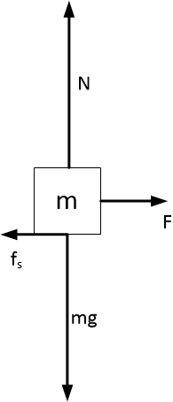

And here I suspect a case of miscommunication ! You draw the friction force that block ##M## exerts on block ##m## in the same direction as the pulling force ##F##. That is indeed not logical !
You can approach this exercise by first thinking about a simpler case: You pull on block ##m## on a floor with friction (coefficient ##\mu_s##). (This is equivalent to letting the mass of block ##m## go to infinity -- such a thought experiment is ver often quite useful ! :wink: ). If you don't pull too hard (##F\lt f_{s,\ max} ##) the FBD is a well-balanced
Friction force ##f_s## has a maximum value ## f_{s,\ max} = \mu N \ ## and as long as ##F## does not exceed that value, the block will stay in position.
Clear so far ? And does it match your intuition/experience ?
So the friction force on the upper block works to the left, not to the right.
This is also the case when the lower block is not infinitely heavy. Logical ?
So, in what direction is the friction force on the lower block ?

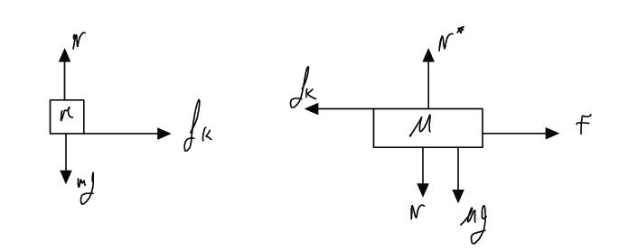

hi, i uploaded another file and i wrote all cases i can think, of this block above block problems. i did a free body diagram , its very long but if you can or someone to see if i did it correct and if i understand what happens in each case.(if i do the free body diagram correctly than all question of this kind would be easy)

Right. So the friction force on the lower block works to the right; same direction as ##F##.
The free body diagrams raise a few questions:
One I can answer: Force ##N## is ##mg## and ##N^*## is ##Mg + N##. But you really should distinguish more clearly between lower case ##m## and upper case ##M##.
The other question is about ##f_k## which you make appear greater than ##F##. Why ? Under what conditions would that be the case ?The problem statement asks for the minimum ##F## required to start the block ##m## to slide on block ##M##.
I agree with with your statement " ##\ f_{s,max} = \mu mg\ ##. "
I do not agree with your statement "The two blocks will move as 1 block with the same acceleration -- until ##\ F\gt f_{s,max}\ ##. " It seems to me you don't either, because you derive (3) ##\ F_M = \mu mg(1+{m\over M})##, (so more than ##f_{s,max}\ ##).
And I think your ##F_M## is the correct answer. I would be surprised if teacher disagrees.

nirlalush said:
and when i put fk bigger then F?
In the picture ##f_k## looks a bit bigger than ##F##. That can never be the case: if you are pulling to the right there is no way the upper block can accelerate to the left.
I suppose you use the symbol ##f_k## for the kinetic friction force. But in the problem statement I only find one ##\mu##, so the best that can be done is to assume ##\mu_k = \mu_s = \mu##.

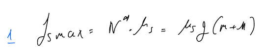

Option 1: There force F is acting on the lower block ##M##. Is this a new exercise, or is this the exercise as it was originally meant by teacher ? Because this is a completely different exercise than the one in Question.pdf and Question (1).pdf.
If this is the actual exercise, I suspect that's where the source of miscommunication is hiding !
I certainly do not agree with
as the maximum friction force between ##m## and ##M##.

\begin{aligned}\sum F_{my}=0\\ N-my=0\\ N=mg\\ f_{s}=\mu_{s} N=\mu _{s}mg\end{aligned}
that on the upper block m.
so in the x Axis of M
\begin{aligned}\sum F_{Mx}=Ma\\ F _{min}-f_{s\max}=M_{a}\\ F_{min}=\mu_{s}mg+M\mu_{s}g\\ F_{min}=\mu_{s}g\left(m+M\right) \end{aligned}
is it correct?
Depends on what you are referring to. Is this the exercise from post #1 where you are pulling the upper mass ? I guess not.
Is this Option 1 in "Block on block scenarios.pdf" ? Where you are pulling the lower mass ##M\ ##, with free body diagrams
then: yes, I think that is right.
