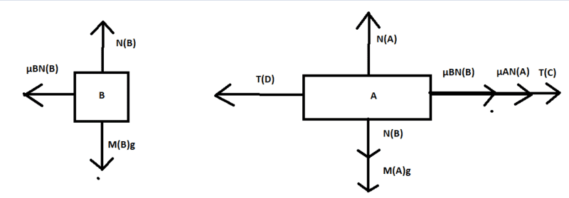

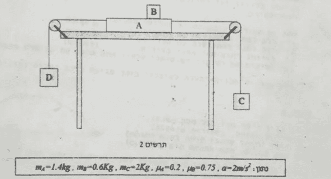

The coefficient of friction between A and the table is μA.
The coefficient of friction between A and B is μB.
A, B, C and D all move with an acceleration of 2m/s^2 (A and B move to the left).
Find the force that the friction between the bodies apply on B.
Find the tension of the yarn that connects A and C.
Find the mass of D.
At a certain moment, the yarn which connects A and D is torn. Will A and B still move together? (Show with calculations)
mA=1.4kg ,mB=0.6kg, mC=2kg, μA=0.2, μB=0.75, a=2m/s^2
*Both times the static and dynamic coefficients are equal.
F=ma
The last question is what I am stuck in, but I don't have the answers so I will show my calculations prior to that.
Forces on A and B: (I hope everything is clear)
mBg=6N so NB=6N, now we could see that according to ma=F, 1.2=F, so the force is 1.2N.
Now if we look at C we could see that 4=TC-20, TC=24N.
Now if we look at A we could see that: mAg=14N, so NA=20N.
Using ma=F: 2.8=TD-1.2-24-0.2*20 so 2.8=TD-29.2, TD=32N
Looking at D: 2mD=10mD-TD, mD=4kg.
Now I am not sure what to do, I tried to draw the forces again, but from there I don't really know what to do. How can I know if C moves now? If it doesn't then A and B doesn't move, but if it does I don't know how to reach the answer.
Thanks in advance!

In your diagram you have assumed that the friction force between A and B is given by μN.
Is this friction force static or dynamic (kinetic)? Can you see why you should not assume that the friction force is μN? Fortunately, in your calculations you never used this assumption. Your results so far look correct to me.
Is this friction force static or dynamic (kinetic)? Can you see why you should not assume that the friction force is μN? Fortunately, in you calculations you never used this assumption. Your results so far look correct to me.
At the instant the yarn breaks, I think they want you to assume the system is in motion according to the setup of the first part of the problem. So, all the blocks have the same speed at the instant the yarn breaks. You'll need to draw new free body diagrams.
I can see why I should not assume this, I just used it to draw the diagram but I admit it wasn't clever to do.
I will try what you said, I just never assume anything and due to that it quite often I can't solve problems. I wish those things would be clearer...

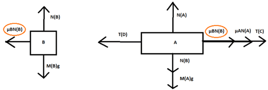

haruspex said:
... And anyway, in this part of the question, using g=10m/s2, it happens that the assumption is correct.
The force of friction on B is 1.2 N. But μBNB = (0.75)(6.0N) = 4.5 N
I should have magnified the diagram. I read the A subscript on μA as a B.

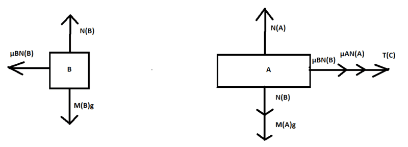

So, after the yarn is torn I am getting this:
So that basically means that they won't move together because their acceleration are different, correct?

I am not at all certain what your diagrams in post #8 indicate. Looks to me like you have the two blocks accelerating in opposite directions, but that makes no sense.
haruspex said:
What assumption do you mean?
This: (what TSny wrote)
This diagram is supposed to show the forces on each block after the yarn is torn.

You are perhaps confusing direction of movement with direction of acceleration.
Since A is moving left, with some inertia, you are right that after the cut the friction from the table still acts to the right on A at first. (I was wrong to say the the initial leftward movement was completely irrelevant.) But think carefully about the interaction between A and B.
Before the cut, friction acts to the left on B because A is accelerating leftwards. After the cut, which way does A accelerate? What does that mean for the contact between A and B?

Wait, so the direction of the friction between A and B on each block would be determined by the direction of A's acceleration and not by the direction of its movement?
It is determined by the relative movement, or tendency to relative movement, of the two surfaces in contact.
Just before the yarn is cut, A and B are moving at the same velocity, but because A is being accelerated left there is friction between the surfaces opposing the tendency for A to move left faster than B. Thus the friction acts to the left on B and to the right on A.
When the yarn has been cut, there is no leftward force on A, except possibly from B. So friction between A and B no longer has to oppose A's tendency to move left faster than B. Indeed, except for B, all the forces on A are now to the right, so the tendency is for A to accelerate to the right. That means it will tend to have a rightward movement relative to B, and the frictional forces between the two reverse.

Now I am not actually sure how to calculate if they will be able to move together. I understood how the forces act, and what I did is to assume that they move together and then check if μB is smaller or equal to 0.75. However I am not sure if I am allowed to make this assumption, how would you solve it?
That is a valid method since it is, in effect, what the masses will do; they will move together until the static friction is inadequate.
