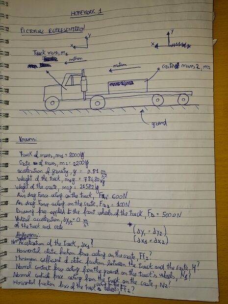

A truck of mass M1= 8000 kg is transporting a crate of mass M2 = 2200 kg. The air drag force acting on
the truck is 600 N and the air drag force acting on the crate is 100 N. If the driving force applied to the
front wheels of the truck is 5000N, find the acceleration of the truck and the horizontal static friction force
acting on the crate. Also find the minimum coefficient of static friction between the truck and the crate
to ensure that the crate does not slide.
Acceleration of the truck?
Horizontal static friction force acting on the crate?
Minimum coefficient of static between truck and crate?

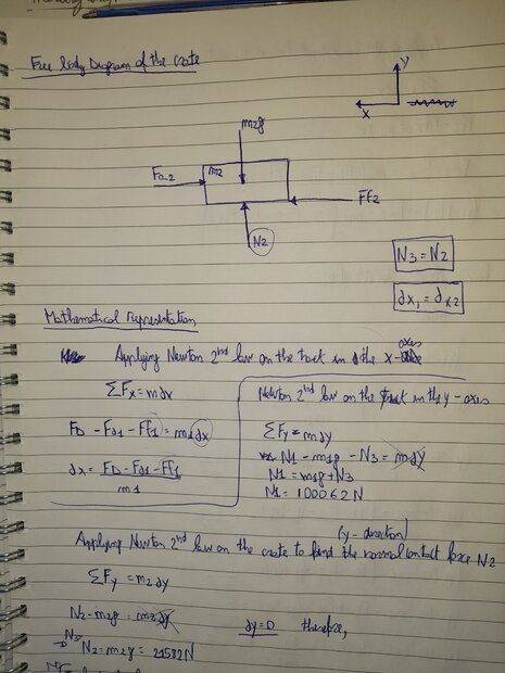

Hi everyone is able to help solve this question for my assignment in university?
I've draw a free body diagram for each component of the question but now i am stuck.

Thanks everyone for the quick reply, appreciated your help.
As you can see from the pictures I've managed to draw the free body diagrams for each components and also tried to apply Newton second law to find the friction forces Ff1 and Ff2 but the coefficient hasn't been given.
What am i suppose to do now to find the acceleration and frictions?

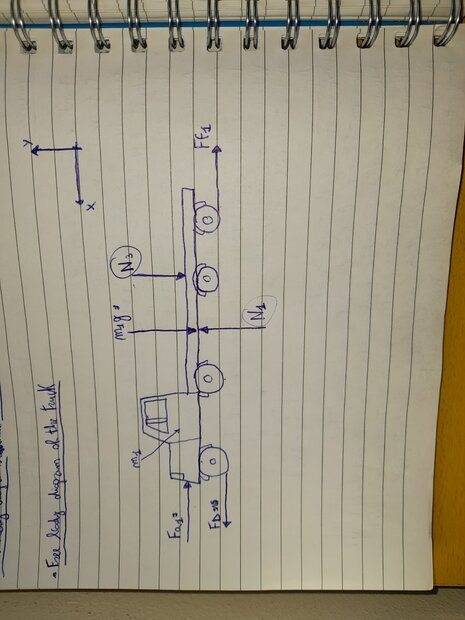

I'll add this, since I'd already drafted it, though it repeats some of what @PeroK has already said...
There are a few mistakes. For example:
A diagram shows force ##F_{f1}##. I’m not clear what this is. The driving force, ##F_D## is meant to the total frictional force between the wheels and ground. (Imagine what happens if you tried to accelerate on perfectly smooth/slippery ice.) In this problem, the wheels are rolling and we are meant to take ##F_D## as the only horizontal force between the wheels and the ground.
[On a more advanced note, we are treating the wheels as having negligible mass, so we are ignoring the torque needed to give the non-driving wheels angular acceleration. But ignore this comment if you don't understand it!]
##F_{f2}## appears to be the force of friction from the truck’s platform, acting to the left on the crate. Fom Newton’s 3rd law, that means there is also an equal magnitude force of friction from the crate, acting to the right on the truck’s platform. But this is missing from your diagram.
Weight is a force, measured in Newtons (N). For example a 100kg mass weighs 981N (on earth). Weight is not measured in kg in a scientific context.
You have taken the +x direction to the left. Not a mistake but a bit unconventional!

One approach is to take a step back. Start with a fresh free body diagram:
Draw a simple picture of ‘truck+crate’ (no ground).
Mark all the external forces, including their values
Work out the reusltant force, F.
Apply F=ma to find the acceleration.
Then draw a free body diagram for the crate alone and take it from there.
With suitable diagrams, each answer should only be a few lines long.

Thanks for the clarification.
Solving for the acceleration I've got 0.55 m/s^2 using the Newton's second law.
So using the acceleration found I've found a force of friction Ff = 1310N
And its coefficient of friction u= 0.06.
Am i right?

No. That's not right. How did you get that?
Applying Newton's Second Law for the truck in the x axis:
Driving force(Fd) - Air force resistance on the truck (Fa1) / mass of the truck (m1) = 0.55 m/s^2
which is numerically: 5000-600 / 8000 = 0.55 m/s^2

2. Find the resultant force on the crate, ##F_2##, the sum of all the forces on the crate.
You do that one yourself.
3. Apply ##F_1=m_1a## to the truck to get equation 1.
I'll do that one for you:
##4400 - F_{friction} = 8000a## (equation 1)
4. Apply ##F_2=m_2a## to the crate to get equation 2.
5. You now have 2 simultaneous equations with unknowns ##a## and ##F_{friction}##. You solve them.
If you don't like simultaneous equations, see the suggested method in my previous posts.
Likes PeroK
  • #35
I've used the simultaneous equations and i 've got for the acceleration ax= 0.39 m/s^2 and for the force of friction f= -880N
Is that right?
