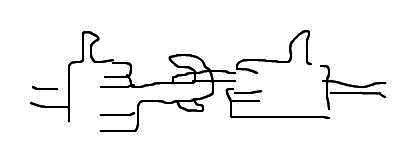

Emma and Caleb are playing a game. I don't know what the name is, but they put their fingers together like a hook and then pull. Caleb won. does that mean that Caleb pulls with greater force than Emma pulls him? Caleb wins. Does it mean that he pulls with greater force than Emma pulls him?
Excuse the awful picture lol
Newtons thrid law
how can he win when the opposite force is qual to his force?
It's true that the forces between the hands are equal and opposite according to Newton's law. Are they affected by any other forces than the forces between them? Consider every force affecting a person and you should be able to resolve this
Well their gravitational force is not the same. caleb is heavier so his force is greater.
That's true, however that force is pointing towards the ground so not in the right direction (and is compensated by the normal force from the ground). Is there a force between him and what he's standing on?
hmm the only forces are the gravity and the friction

No, it means that Emma's grip is weaker. There are different forces at play here, doing different things. Her finger was unable to retain the "hook" position against the force applied by both of them pulling (equal opposite forces). Caleb had a stronger "hook" than Emma, but at no time were the normal forces at their join different (Newton's 3rd).
Friction plays no role here.

Hand muscles.

1st what are the two interacting objects in the system? Calebs finger and Emma's finger. Anything outside of these two things are not in the discussed system.
2nd at all points where they are in contact the force of Calebs finger on Emmas finger is equal (but in the opposite direction to) Emma's finger on Calebs finger.
Equal but opposite does not mean the same result for both interacting objects. Think bug and car windshield. When a bug hits the windshield the force of the bug on the windshield is equal in magnitude to the force of the windshield on the bug. The resulting effect on each object however is far from the same. Bug goes splat windshield is just fine.

Hopefully this explanation will help. Assume Caleb is on the left. Consider each hand as an object. There is a Newton third law pair of equal in magnitude and opposing forces, Caleb's hand exerts a leftwards pulling force onto Emma's hand and Emma's hand exerts a rightwards pulling force onto Caleb's hand. Now consider the forces on each hand. Caleb's arm pulls leftwards on Caleb's hand, Emma's hand pulls rightwards on Caleb's hand. Likewise, Emma's arm pulls rightwards on Emma's hand, Calebl's hand pulls leftwards on Emma's hand. At the moment Caleb starts to win, the leftwards force exerted by Caleb's arm is greater than the rightwards force exerted by Emma's arm. This results in an imbalance in force of the hands, and the hands accelerate to the left. Although the magnitude of tension between hands may have changed, the tension between the hands remains a Newton third law pair of equal in magnitude but opposing forces. Part of the tension between hands is related to the mass times acceleration of Emma's hand. Part of the tension in Caleb's arm is related to the mass times acceleration of Caleb's hand, Emma's hand and Emma's arm.

So basically the force with which Caleb's arm is pulling his hand is greater than the force Emma's arm is pulling her hand, causing her hand to shift towards Caleb due to the imbalance of the total net forces acting on each of their hands? Your explanation makes sense with considering that there's also the force of their arms pulling on their hands but it sort of sounded confusing at first.
