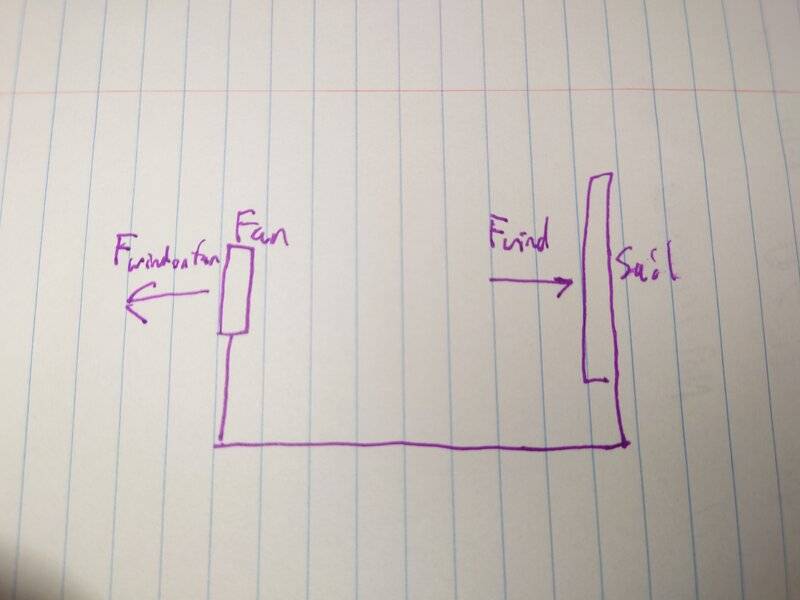

rosedog09
An ice sail craft is stalled on a frozen lake on a windless day. A large fan blows air into the sail. If the wind produced by the fan strikes and bounces backward from the sail the sail craft will move
a. to the left (forwards)
b. to the right (backwards)
c. not at all
Conservation of Momentum
C. There is no net change in force, momentum, or velocity of the sail craft because the fan exerts a forward force on the air; however due to Newton's third law the air exerts an equal and opposite force on the fan. This air then exerts a forward force on the sail which cancels out the rearward force of the fan.

I understand that the sail will enact a forward force on the cart due to newtons third law from bouncing the air back, but I dont understand why this force would not be counteracted by the force which air exerts on the fan (Newtons third law).

Ok so what your suggesting is that the momentum change (impulse) on the sail is greater than the fan because the particle is reversing directions. I can understand this, but I still find it hard to understand how there is enough momentum from the fan for it to transfer more momentum to the sail than the fan transferred to the air.

Ok. I think I've figured it out. The sail is reflecting the air (in this case with an unrealistic level of efficiency) such that momentum goes from p to -p, a total change of -2p. Since the fan initially transferred p to the air we are left with -p, so it is essentially the same as having the fan pointing backwards. I think my confusion is coming from the sail because I dont understand what would cause the sail to enact enough force on the air to reverse its direction.

What I don't understand/bothers me is the forces in this system. To me it seems like the force of the air on the fan and the force of the air on the sail would cancel, but they dont as we can see from the change in momentum. Im confused as to where that extra "force" is coming from.
You can't compare forces like that. If I hit a ball with a bat, the bat exerts quite a large force for a short time on the ball. If you catch it, you will exert a smaller force for a longer time. The momentum changes cancel but the forces don’t.

This makes sense. I didnt think about the timing of it.
Why? There is no reason they should. They are not a third law pair.
