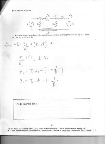

My attempt is in the figure.
Is this is what they are asking for? Or do I need to add something else? Is what I have correct?

I'm not sure what 'the node method' is, but in your first line you say current + current + voltage + voltage = 0, is this meant to be a kirchhoffs voltage law around a loop somewhere, or kirchhoffs current law at a node somewhere?
Either way, the algebraic maths going from line 2 to line 3 is incorrect, for starters.

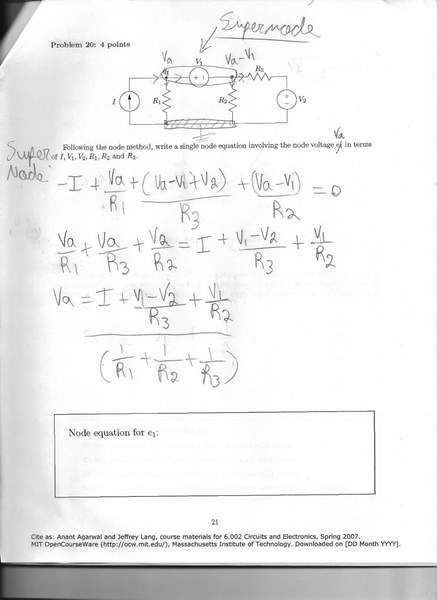

Here's my 2nd attempt using a super node. (Instead of using [tex]e_{1}[/tex] I simply defined it as [tex]V_{a}[/tex])
EDIT: I fixed that attachment.
So the final equation should be:
[tex]V_{a} = \frac{I + \frac{V_{1}-V_{2}}{R_{3}} + \frac{V_{1}}{R_{2}}}{\frac{1}{R_{2}}+ \frac{1}{R_{2}}+ \frac{1}{R_{3}}}[/tex]

If the voltage at the second node is (Va - V1) V, and the voltage on the other side of R3 is V2 V, then the current through R3 (the third term in your first equation) might be wrong.
I'm unfamiliar with the correct analysis process, but otherwise the maths is correct ;)

In your supernode attempt, your first equation is:
[tex]-I+\frac{V_a}{R_1}+\frac{(V_a-V_1+V_2)}{R_3}+\frac{(V_a-V_1)}{R_2}=0[/tex]
which, with an extra set of parentheses, is:
[tex]-I+\frac{V_a}{R_1}+\frac{((V_a-V_1)+V_2)}{R_3}+\frac{(V_a-V_1)}{R_2}=0[/tex]
Everything is correct except that you have a wrong sign on V2. It should be:
[tex]-I+\frac{V_a}{R_1}+\frac{((V_a-V_1)-V_2)}{R_3}+\frac{(V_a-V_1)}{R_2}=0[/tex]
So, your final solution is correct except for a wrong sign on V2.
Why is V2 negative?
The voltage (difference in potential) dropped across a resistor is equal to the higher potential minus the lower potential.
In the case of R1 and R2 you have the ground as the lower potential, which is equal to 0V, and this is the case for most of the introductory equations when you learn about voltages.
[tex]\frac{V_{a} - Gnd}{R_{1}}[/tex] = [tex]\frac{V_{a}}{R_{1}}[/tex]
[tex]\frac{(V_{a} - V_{1}) - Gnd}{R_{2}}[/tex] = [tex]\frac{(V_{a} - V_{1})}{R_{2}}[/tex]
However, in the case of R3, you have V2 as the lower potential.
jegues said:
Why is V2 negative?
Because the current through a resistor is equal to the difference of the voltages (not the sum) at the two ends of the resistor divided by the resistance.
