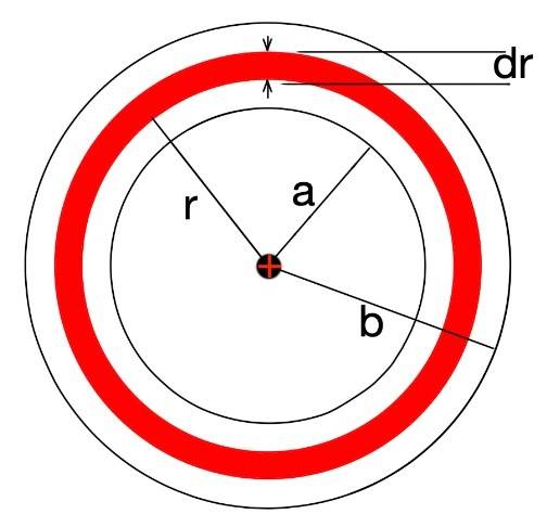

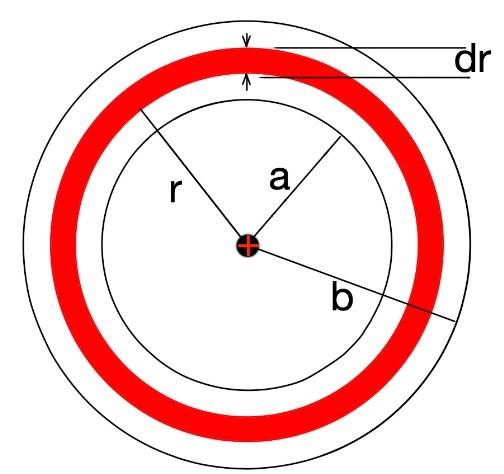

##\rho dV=dq## is just the definition of charge density. A volume element of size dV in a region where the charge density is ##\rho## has charge ##\rho dV##.
Consider a spherical shell element radius r, thickness dr. It has volume ##dV=4\pi r^2dr##, and the charge density there is given as A/r, where A is some unknown constant. (You can think of it as an area density, but it doesn't need to be anything of natural physical significance. We might have been told the density is any strange function of r.)
We are asked to find a value for A such that the field within the charged shell has constant magnitude. Obviously the field is spherically symmetric, so we can take it as radial.
This means we need a general formula for the field at any given point between radii a and b. It is not adequate to find an A that makes the field the same at a and b (though that would probably lead to the same answer).
There are two ways to proceed from here. We can find the total charge inside radius r (including the isolated charge), then write down the field that produces at radius r, or we can find the field at r due to charge in the shell from a to r and add the field due to the isolated charge. The result will be the same.
I chose one, the solution at your link chose the other.
